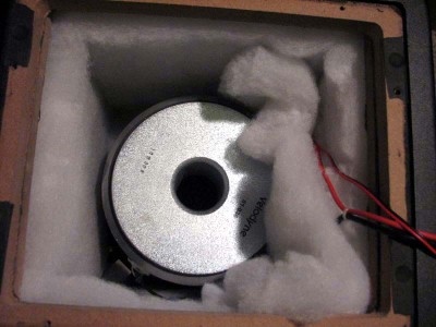

The internal
crossover system for signal input is adjustable from 40 to 120 Hz and uses
staged for low pass filtering that according
to Velodyne varies between 12
dB/octave at the crossover frequency to 48dB/octave above the crossover
frequency. The line level output is fixed at 80Hz with a 6dB/octave slope
The driver used in the Photon-8 has an 8 inch outside diameter with an actually 6.5 inch effective piston diameter. The cone itself is a composite resin that is reinforced with Kevlar fibers and is mounted to the frame with an oversized EPDM rubber surround while the internal suspension is said to use an oversized spider, both to accommodate high excursion but retain linearity.
The motor structure on the back of that cone is also appreciably oversized. The magnet structure weighs in at 204 oz (12.7 lbs) that effectively constitutes fully 1/3 of the entire subwoofer system's weight and weighs more than some comparably sized subwoofer systems. In between the cone and that magnet is a high temperature, 2.5” diameter, dual wound coil. Coupled with a cast aluminum basket frame and we have the makings of what should prove to be a very potent little driver.
The MiniVee is not video shielded but this is an ever diminishing problem in this era of post CRT display technologies. If video shielding is an important consideration the MiniVee-10 is shielded, which provides an accommodating option in the product line.
The Velodyne MiniVee also boasts a
digitally controlled class D amplifier (up to 95% claimed efficiency at full
load) section that is said to deliver 1000 watts rms power
and 2000 watts
dynamic power. The amplifier, which is separated
into two sections, occupies the entire back plate. One board dedicated to the
power supply supporting the transformer and main fuses. The second tiered board
supports the preamp functions and six 470 microFarad, 200 V power supply
capacitors. There is a small heat sink to the side of the capacitors while the
majority of the circuitry lives under a grilled metal housing to reduce
radiated RFI noise inherent in high frequency switching amp designs. Based on
the power consumption rating of 8 amperes listed on the back of the unit at the
standard 120 volts we get a power rating of P = 0.95(8A * 120V) = 912 watts
which is close enough to the 1000 watt rating that with a slo-blow fuse leaves
little to suspect the rated power of the amplifier.
Both the amplifier and driver feature overload protection circuitry. The driver is digitally controlled with a current limiting driver servo to limit distortion by prevent clipping and over excursion. The amplifier section has thermal protection as well as protection against excessive voltage drops. As you will see in our measurements section, this little sub is unbreakable.
Velodyne MiniVee Internal View
Disassembly of the MiniVee to reveal the internals can only (safely) occur through the rear amplifier plate, which is secured with 10 wood screws around the perimeter. Inside the cabinet, fiber batting is wrapped around the outside faces of the cube and a second piece separates the driver from the electronics mounted to the back. The cabinet itself is constructed of 1/2” MDF with glued joints and triangular wedges used to reinforce the outside corners. The driver is secured down with metal clamps. It's obvious Velodyne designed this sub to be rattle-free at even the highest power levels.

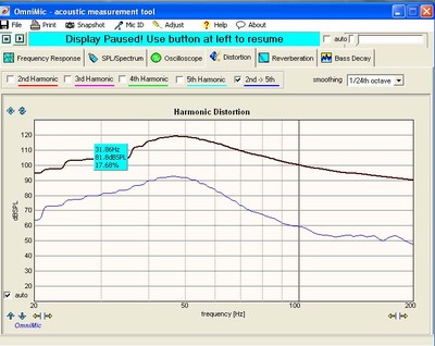

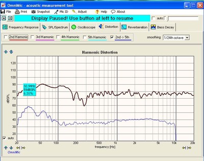

Velodyne MiniVee Measurements and Analysis
I measured the Velodyne MiniVee in my office space using the antiquated but accurate Linear X LMS measurement system. No smoothing was used unless otherwise indicated. I also used the new Dayton Audio OmniMic system to measure system distortion.
Velodyne MiniVee Nearfield Frequency Response
I measured the MiniVee at various output levels using the groundplane technique at 3 inches from the front driver. The output was scaled -19dB down to give the actual SPL output I could hear at my listening position which was roughly 4 feet away. The subs highest output is centered around 50Hz but rolls off significantly below 30Hz where there is a deliberate HPF employed to protect the drive unit and keep things from getting ugly. I was a bit surprised to see about 5dB of rolloff at 80Hz even with the subs internal crossover bypassed. I could only surmise that the inductance of the large voice coil and heavy cone of this smallish driver was contributing to this phenomenon. It certainly explains why I opted to use no bass management at all on this sub when mating it with my EMP 41-SE/B desktop speakers.
Unlike the MicroVee that drops off like a rock below 50Hz, the MiniVee has about a 10Hz true usable extension advantage. I was able to hit 106dB SPL at my listening seat with this potent little sub which was about 5dB more output than I measured on the MicroVee at 50Hz and whole lot more below 50Hz as you will see in my comparative measurements below. Velodyne claims the -3dB point of the MiniVee is 28Hz. Because of the bump at 50Hz, it’s a bit hard to give an exact figure here. I would say its more like 30-32Hz. At high SPL however where the sub compresses and the limiter kicks in, we see a 38Hz -3dB point with about an 18dB/Oct roll off. This is very respectable performance for a product smaller than a shoebox.
I found it to be revealing to compare the output of the Velodyne MiniVee to the smaller but more expensive MicroVee model. I tested both subs identically using in-room nearfield groundplane scaled to the listening position 4ft away.

Velodyne MiniVee Distortion @ Max Output
At moderate listening levels which would equate to about (81dB @ 40Hz) at my listening position, I measured under 1% distortion below 60Hz on the MiniVee. It wasn't until I ran the sub to its max output that you could see distortion rise appreciably. At 31Hz max usable output, I measured 17.68% which is actually quite excellent for a subwoofer driver. Distortion below 30Hz dropped thanks to the HPF system limiter doing what its supposed to do to protect the driver and ensure you can't hear any audible distress.
I measured distortion of the Velodyne MiniVee sub used in conjunction with my EMP 41-SE/B bookshelf speakers as you can see below.
Velodyne MiniVee + Speakers System Distortion vs Frequency
If you subtract the frequency response curve (brown) from the distortion curve (blue), you can calculate THD +N. using the table below:
| dB Below Test Tone | % Distortion |
| -5 dB | 56.2% |
| -10 dB | 31.6% |
| -15 dB | 17.8% |
| -20 dB | 10.0% |
| -25 dB | 5.62% |
| -30 dB | 3.16% |
| -35 dB | 1.78% |
| -40 dB | 1.00% |
| -45 dB | .562% |
| -50 dB | .316% |
| -55 dB | .178% |
| -60 dB | .100% |
So in our case, above 200Hz we see 80dB SPL level - 40dB distortion level yielding 1% THD + N. The overall distortion profile of this system from 20Hz to 20kHz is quite excellent which explains why I enjoy listening to my desktop system often moreso than any other system in my home. It plays plenty loud and clean with great bass extension thanks to the MiniVee. What else could anyone want from a desktop system?
