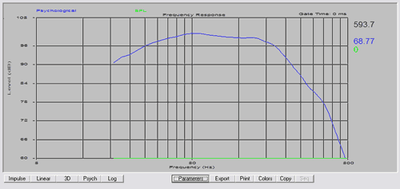

To measure the subwoofer's frequency response I placed the unit outside, set the gain to the THX setting (about 1-4 volume) and bypassed the variable crossover. Using the Rives Audio Pro Test Kit, and placing the microphone at ground level approximately one foot from the woofer cone, I conducted the frequency response and SPL test as shown in the accompanying graph.

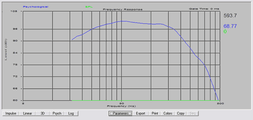

As you can see from the frequency response, the Velodyne HGS-15X had very impressive low-end extension with useable high SPL starting at about 18Hz. The frequency response between 25Hz and 150Hz is fairly flat as shown in the below graph , confirming what I heard during the listening evaluation and explaining why the Velodyne HGS-15-X was able to integrate seamlessly and smoothly with my main speakers when crossed over at 80Hz.
The frequency response graph and charted SPL levels show that this subwoofer can play ridiculously low frequencies with high SPL 舗 s and have a very flat response between 25Hz and 150Hz +-3dB. Low, loud and smooth equate to an audiophile subwoofer with slam.
