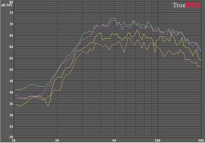

I find testing a subwoofer at such low decibal levels does not tell me anything. Most good subwoofers roll off at the 80dB level, but are capable of much more.
Here is a subwoofer shootout list if anyone is interested. If you look at the data, you will find that most of the subs tested were ran well into the triple digits and quite a few averaged triple digits with +/- 3dB or so.

As Tom mentioned in the review of the Velo is that it starts to roll off significantly below about 28Hz. For HT you definitely want good response down to 20Hz. Another concern for you is size and the need for a front firing/ported or sealed sub. There are a few decent options to choose from. The SVS PB12-Plus, Epik Vanquish/Sentinel/Dragon, eD A7S-450/A5-350.
