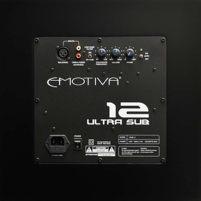

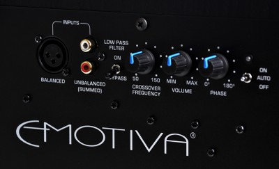

On the back you've got both balanced (a rare find on any consumer subs, especially at this price) and unbalanced inputs. There is a Low Pass Filter switch to defeat the internal crossover, which goes from 50-150Hz. Variable volume and phase adjustment are also available, as is a switch for setting the sub to continuous, off, or auto-sensing mode. In Auto it draws 2 watts and goes standby after 10 minutes of no sound. One problem we found with this sub (which Emotiva promises to fix) is that it doesn't have an auto-muting function, so it "pops" each time you connect or disconnect a cable to the inputs. In normal day to day operation this would never be an issue but more of a pet peeve to folks like us that hot swap cables to test multiple products at any given time. We recommend powering down products before disconnecting them despite the fact we don't always practice what we preach.
Emotiva Ultra Sub 12 Backpanel
About the only thing you won't be able to do with this subwoofer is feed it speaker level inputs or use it to crossover full-range frequencies to a pair of satellite speakers (there are no speaker level inputs or outputs whatsoever). With a modern AV receiver this shouldn't be a problem, but if you have a lower-tech integrated amplifier or a true legacy system or audiophile rig, you may need to look into an external crossover.

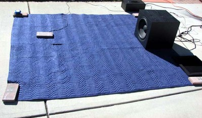

All tests were conducted using 1 meter groundplane technique outdoors. The mic was placed on the floor firing at middle of the cabinet surface containing the 12" driver. The grille cover was removed during this testing. All tests were conducted using continuous sinewave sweeps which produce RMS SPL outputs as opposed to CEA2010 burst testing which produce max SPL outputs 3dB higher than RMS equivalent measurements (at the products maximum output limit). Sweep tones tend to really stress a subwoofer as the motor structure warms up and pushes the sub out of its nominal operation like it would in real world usage but they don’t allow for the ability to find max SPL per discrete frequency like the CEA2010 test method. In the future, we will conduct both types of measurements to get a clearer understanding of product performance and limitations.
