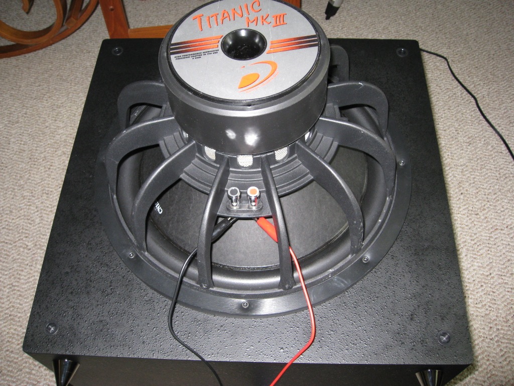

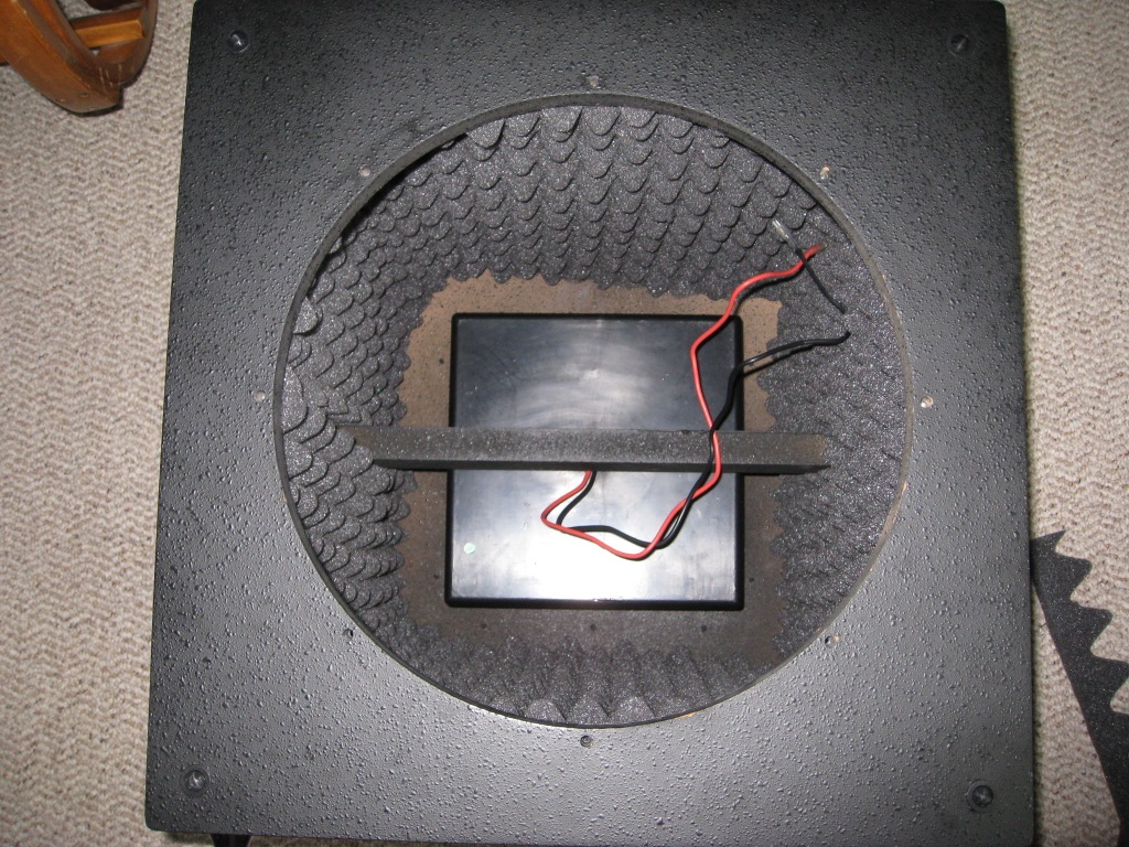

TitanicConstrAfter doing my design comparisons and concluding that the given cabinet in the kit was very close to the suggested design by WinISD for a closed box system it was time to put the T1503 kit together. Before I started just pulling out the tools and connecting things up I read the assembly instructions in the User’s Manual which can be very important for a novice speaker builder. Well for only having a 4 page document I was extremely impressed. After a short introduction to the kit, it lets you skip to the Features section if a pre-built kit was purchased. To build the kit only 4 tools are required, screwdriver, hex driver, wire stripper and a utility knife; although they forgot to include a mallet. It gives a specific order of what to install first and why. It even suggests sealing the threads of the spikes which I have always done on my own but when using these spikes I think it is required since they can only be hand tightened. The kit was very easy to put together; the toughest part was installing the driver. I liked the fact that it had pre-installed T-nuts for the spikes and the driver but I have found that if the T-nuts are only hammered in as they are here they can be pushed out and that is what happened. I use T-nuts in my own speakers but I’ve learned to put some epoxy on them to hold them in place. The driver is very heavy and some of the holes are partially blocked by the gasket so the bolts need to be pushed completely through the holes and then aligned with the holes in the cabinet. Pay heed to the instruction’s warning about cross threading the bolts, it is very easy to do. I had to back out some bolts and retry several times. The amplifier used standard screws but I don’t think it needed T-nuts. Although not a detriment, I didn’t like how long the screws for the amp were and that they protruded through the wood. The instructions don’t mention installing the grill but it’s pretty intuitive, just tap the sockets into the pre-drilled holes with a mallet and install the grill. I was humored by the comment to discard the extra T-nuts; if you’re like me you would save them for your next project.
The Dayton Audio User’s Manual not only covered instructions for putting the kit together it also covered some basics on subwoofer placement which were accurate and helpful. The only shortcoming I found with the instructions was it had no suggestions for setting the parametric equalizer. Although, as I stated earlier, setting the parametric equalizer had no affect on a closed box of this size that puts a lot of dampening on the driver. There is another use for the equalizer though. If the room response has a bad peak, the equalizer could be used to remove it. Note that the same does not work for a room null, no matter how much you try to amplify it, the room’s characteristics will still cancel out that frequency.
TitanicMK3The driver itself is treated paper with a hefty cast frame and a 136 oz. magnet. I did not see distortion measurements on this driver from either Zaph or Mark K’s web site so I am not sure of the distortion characteristics. The cabinet was made from ¾ inch MDF with one brace from side to side. I typically like to see at least the front baffle at 1 inch MDF but it probably won’t make a huge difference. The cabinet also had rounded edges and the finish was a textured flat black paint. The black chrome spikes were very versatile. The tips could be removed or it could be used with the included metal disks if placed on a hard floor.
