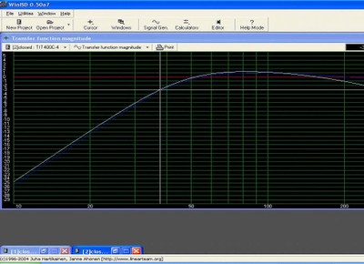

The sealed cabinet is a big compromise for drivers, and with most drivers, it means substantial impairment vs. other designs that are ported. There are exceptions of course. Take a super woofer, like a JL W7 or TC Sounds TC3000 or ULTRA LMS, and it will excel even in sealed systems, due to the insane excursion, motor linearity and power handling ability these units possess. But, 99.99% of all woofers do not come close to the characteristics of these super woofers. The Titanic is a good quality unit, but like most, suffers highly when compared to a vented design. Use it in a vented design, and it will radically improve in performance.

I'm sure you'd get all the depth you'd want with a larger, vented cabinet w/this driver... -TD
