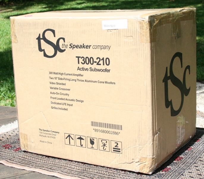

T300_box.JPGThe tSc T300 sub arrived double boxed and well packed. In full retro fashion, they even had packing peanuts. The interior box was branded and marked but the exterior was plain. I prefer this as it doesn't give away to the shipping company (who may decide to leave the box on your doorstep) any indication of what is in the box. It was marked with "Fragile," "This End Up," and "Caution, Heavy" stickers (not that I think they pay those the least bit attention). Regardless, the sub arrived undamaged by shipping and ready for battle.

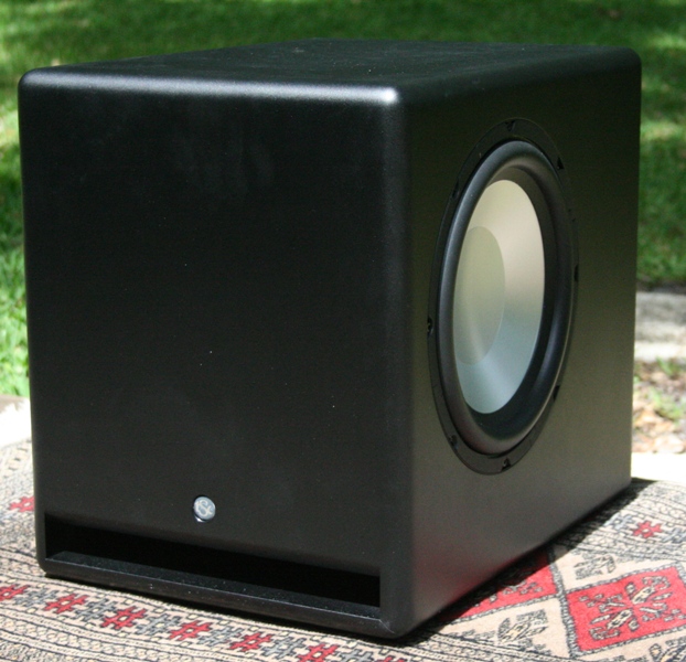

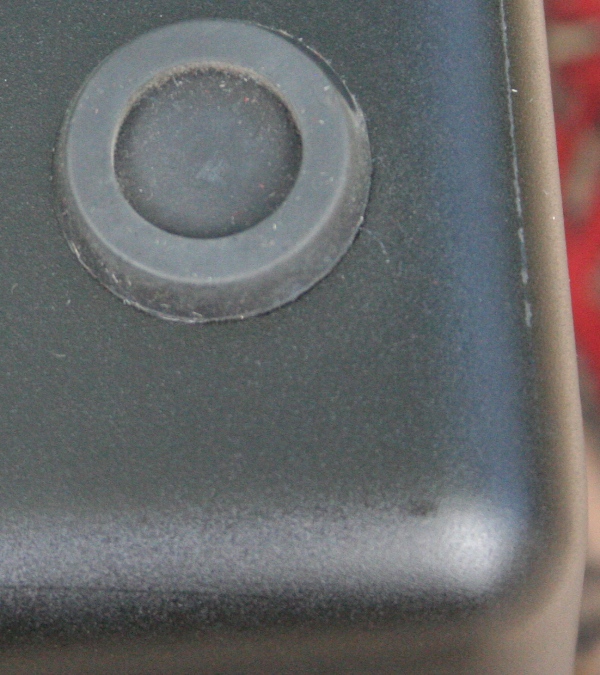

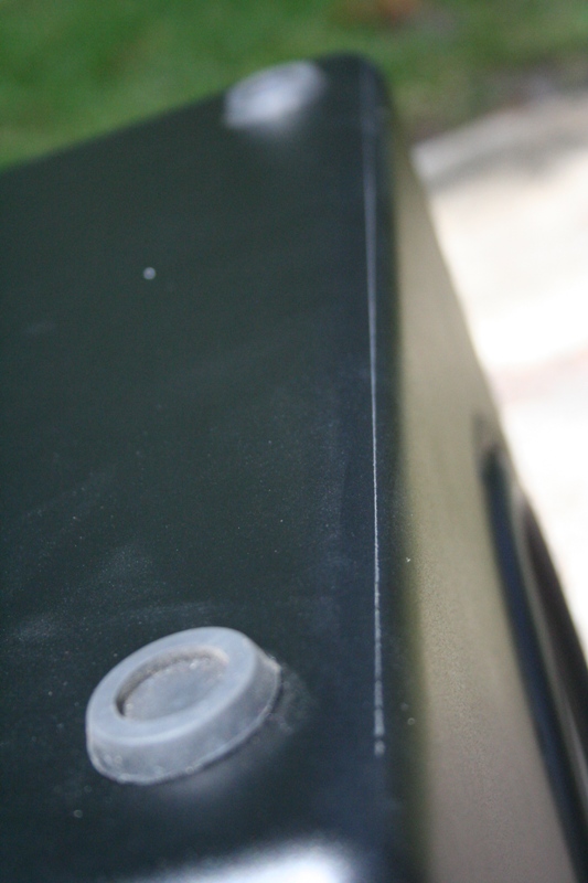

The T300 isn't especially large (a plus for placement and moving around). It is only 14 1/2” wide and 18 1/2" deep. The depth is really the only dimension that should give consumers pause. As always, when buying a subwoofer online, construct a box out of cardboard of the same dimensions and make sure it will fit your space. The T300 features a flat black, slightly textured finish and rounded corners. The stock picture on the website shows a seam on the front but the review unit did not - the front face was smooth. There are two side firing (one from each side) woofers and a front firing slotted port. The bottom has pre-attached rubber feet which are fairly short. There are no provisions for carpet spikes.
T300_angle.JPGThe T300 weighs in at a paltry 36lbs. While this isn't the lightest sub you're going to come across, it does make it very easy to move around. There are two side-firing 10" aluminum drivers, a front slot-style port, and a rear mounted amp. The grills are actually mounted through four of the holes that would be used for mounting the drivers. This leaves four (instead of eight) connection points for the driver to the enclosure. My first concern was that those holes might be predrilled and allow extra avenues of escape for air other than the front port. I did multiple tests during playback and found no evidence that any air was escaping any of the holes.
The grills fit snuggly but not tightly. This means that they won't be falling off on their own but they also won't resist the prying of curious little fingers. The front slotted port is wide but unobtrusive. In fact, if I had to describe the T300 in a word, I'd say it was unobtrusive. The flat black blends well with the shadows and the overall look doesn't exactly draw the eye. It does pick up fingerprints fairly easily but they aren't easy to see in a darkened room. The driverless front of the T300 should get most the credit. However for those that like to see their subwoofer work during those intense action scenes, you'll have to turn the sub or just make due with what you can see of the rubber surrounds moving.

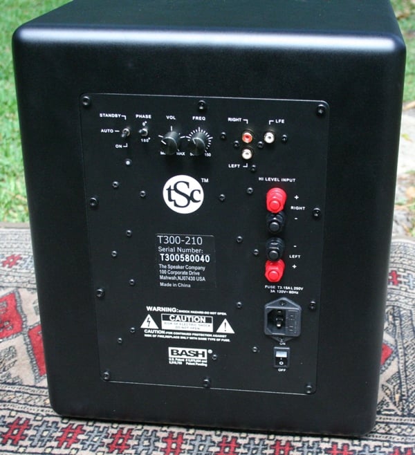

T300_back.JPGThe amp sports 300 watt Bash Class D amplifier and all the usual connections and controls. Variable volume and crossover control (50-150Hz) are present. Phase switch (0-180 degrees), stereo RCA and LFE inputs and high level inputs also there. One thing I wasn't expecting was not only a Standby/Off switch but also an On setting for those (like me) that don't trust auto-sensing functions.
The only fit and finish issue I found was a bit of a crack along the bottom of the box. It was right along the edge along the side at the bottom. While this particular imperfection was invisible to the owner, it might indicate a systemic problem. New owners should be aware and check out their new purchase thoroughly. With free return shipping and a 30 day trial, this shouldn't deter any potential buyers.

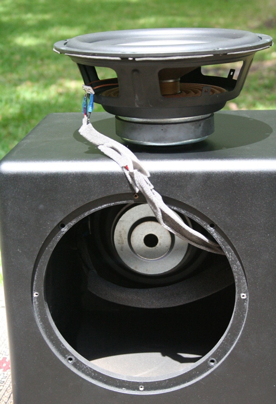

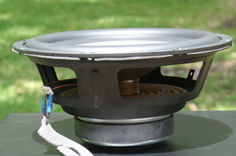

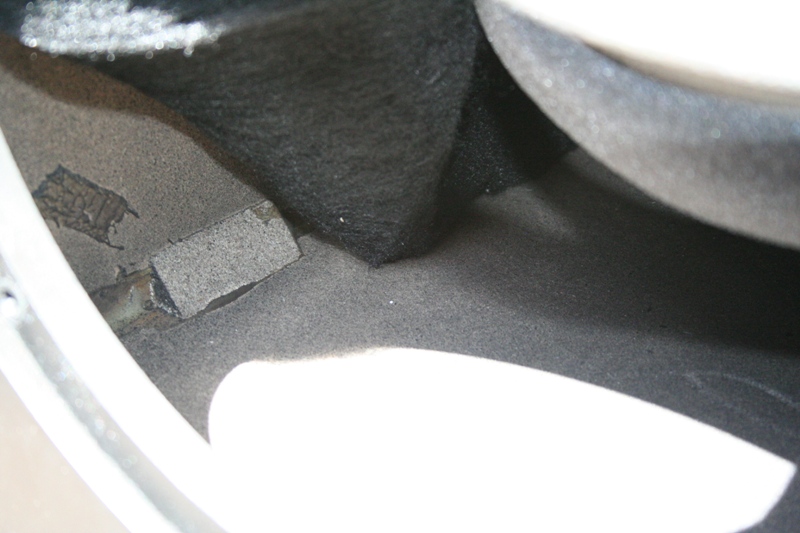

Opening up The T300, we see two drivers in a 3/4" MDF enclosure. The drivers sport stamped rather than cast baskets which is probably not unreasonable considering the price. The drivers also aren't magnetically shielded so you'll need to keep the sub away from any legacy CRTs or other magnetically sensitive equipment. The cabinet has modest stuffing and only a minimal reinforcement at the corners. One thing I was really impressed to see was total dampening of the internal wiring. Each wire was covered with foam tape so that any possible internal noise would be eliminated. A really nice touch at this price point.
