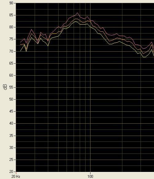

For laboratory measurements I used the Sencore SP395A FFT Audio Analyzer. Placing the subwoofer outside, I did groundplane measurements at 1 meter. During the test, when pushed hard I noticed some chuffing from the port and a bit of rattling from the amp.

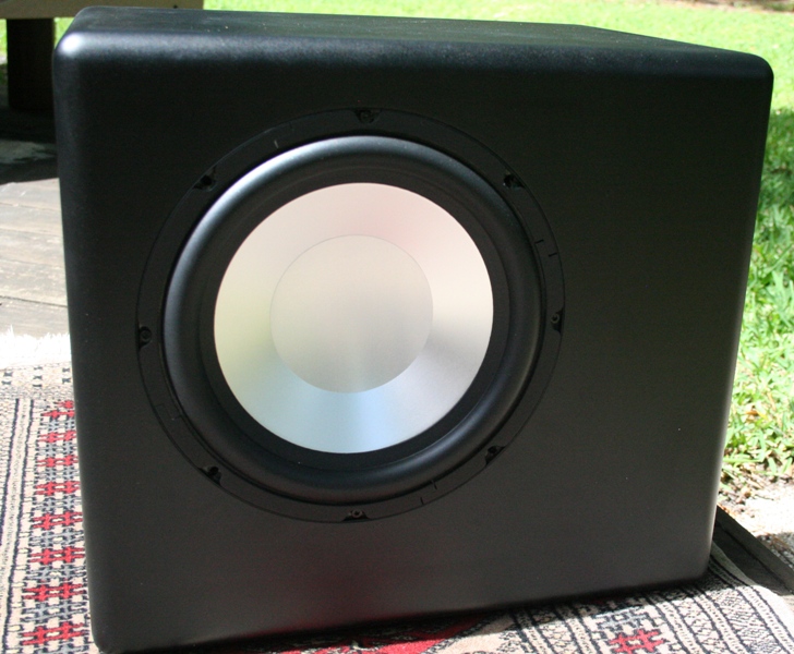

T300_side.JPGMy first step was to send a few test tones with the Rives Test CD II. The Speaker Company claims a usable frequency response down to 19Hz. That's got a lot of bass heads real excited - especially at this price point. Using my Radio Shack SPL meter placed on a stand at my listening position, I measured 81dB at 1kHz. Yes I know the sub isn't playing at 1kHz but I wanted to get a relative measure of loudness in my room with my other speakers. This told me that if the T300 was really giving good output down to 19Hz, I should be able to measure something close to that dB level with a lower test tone. When I bumped the Radio Shack corrected tones down to 20Hz and even 25Hz, I got about 76-78dB. Not bad until you consider that it was all port noise and chuffing. It wasn't until the 31.5Hz tone that I got clean output. Now, as I said, my room is heavily treated and is therefore much larger to a sub than the dimensions would suggest. In a smaller room, the 19Hz claim might be valid but in mine, I probably wasn't seeing much usable output under 30Hz.

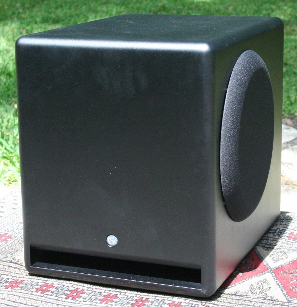

T300_front.JPGDuring the review of the T300 my AV Rant home theater podcast sponsored PS3 arrived. I thought about holding out on my first Blu-ray purchase for something meaningful (like the extended versions of Lord of the Rings) but when I saw Serenity on sale for $16.99, I couldn't resist. DTS Master Audio didn't hurt either. With the wife and kids out of the house and my system cranked, I settled in for a wild ride. Well, the T300 provided a few bumps right away. At the beginning of the movie there are a few really low notes that had the sub chuffing and clanging like a train. I'm pretty sure I bottomed out both the woofers. I tried recalibrating my system and even defeating the Velodyne SMS-1, but nothing helped. Nothing except lowering the volume. The T300 had clearly met its match - at least in my room. In a smaller (or at least enclosed) room, you're probably not going to run into these problems and honestly, for 90% of my listening I didn't either. But throughout the movie I could hear the sub straining and compressing even at lower volumes. Don't get me wrong, the T300 seems to be a great little sub, but it just isn't going to be able to fill up a large room by itself. Of course, at this price you could get two or four…
