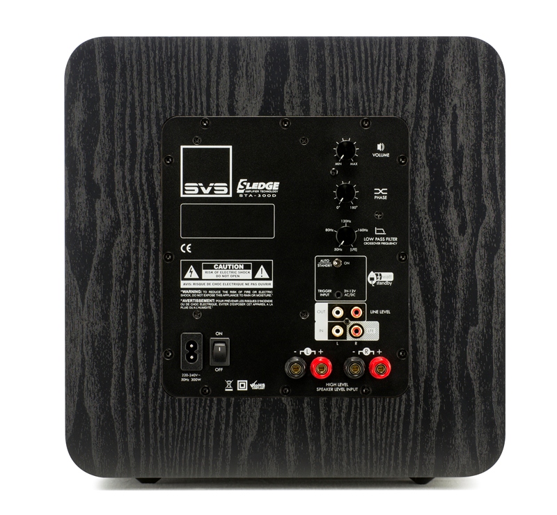

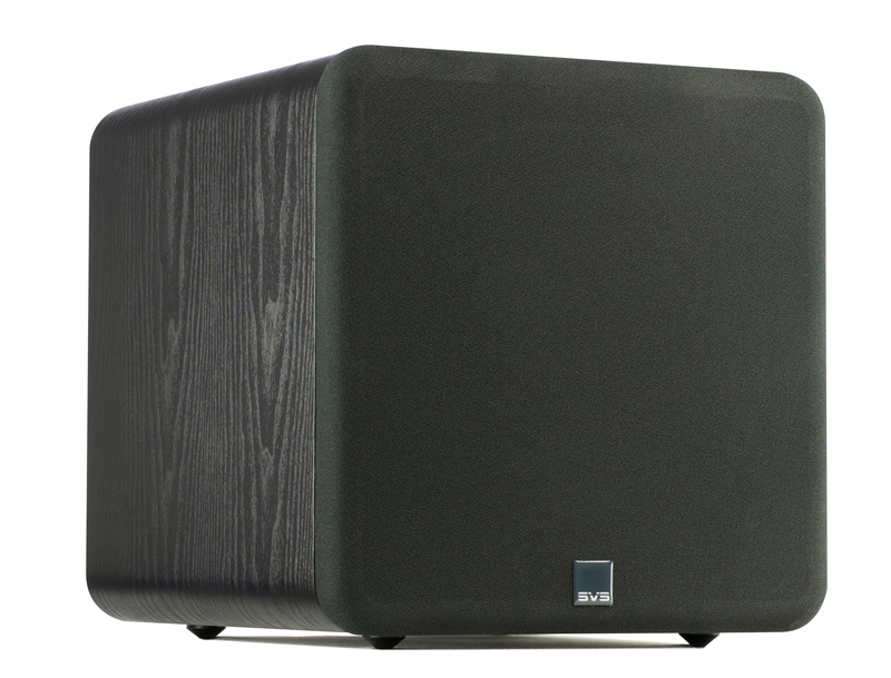

The SB-1000 offers high performance in a small package. Consider it the little brother of the SB12-NSD we reviewed. With a 13" square cabinet and overall dimensions of 13.5" (H) x 13" (W) x 14.6"(D)(includes feet, grill, amplifier), the SB-1000 is easy to hide. Unlike many other small subwoofers, it is still rated to play low, 24-260 Hz +/- 3 dB. Don't worry about fudged specs, the 24Hz rating is from a 2m ground plane measurement away from any reflections. It is only offered in one finish option, black ash. If the subwoofer is going to be hidden, then black ash is fine; otherwise, it would be nice to see a gloss or matte black option. It sports a single front-firing long-throw12" driver with vented pole piece, high-power voice coil, and  FEA-optimized motor technology for low distortion. The amp is a Sledge STA-300D with 300 watts RMS and 700 watts peak. Unlike many power ratings, these specs are on the conservative side. One of our favorite features is the DSP control, which means you shouldn't have to ever worry about pushing the subwoofer too hard. The SB-1000 sports stereo line-level and speaker level inputs and outputs, so it will hookup to any receiver. The low pass filter, volume, and phase control are all continuously variable. The control knobs are actually digital actuators for precise and noise-free adjustment. Eco-friendly consumers can also rejoice because of a .5 watt standby power consumption, RoHS compliance, and lead-free construction.
SB-1000 Rear View     SB-1000 Angle With Grill
         SB-1000 Rear View                      SB-1000 Front View With Grill

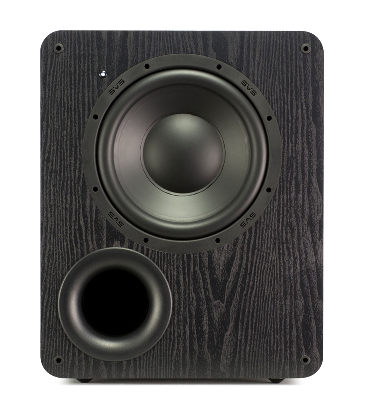

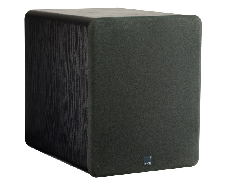

The PB-1000 shares a lot in common with the SB-1000. The amp, inputs/outputs, DSP control, black ash finish, $499 MSRP, etc..., are all the same. The difference is in the cabinet size, frequency response, and driver configuration. The PB-1000 has a single 10" front-firing driver and a 3.5" port with inner and outer flares. This configuration allows for a lower frequency response of 19-270 Hz +/- 3 dB compared to the 24-260 Hz +/- 3 dB response of the SB-1000. The trade off is a larger and heavier enclosure. The PB-1000 is 46lbs (compared to 27lbs) with a 18.4" (H) x 15" (W) x 18.4"(D) cabinet and overall dimensions of 18.9" (H) x 15" (W) x 19.9"(D)(includes feet, grill, amplifier). Still, the PB-1000 is by no means a huge sub. For people who want more bass and/or have larger rooms, the PB-1000 is going to be a better option than the SB-1000.
PB-1000 Front View No Grill     PB-1000 Front With Grill
PB-1000 Front View Without Grill         PB-1000 Front View With Grill
