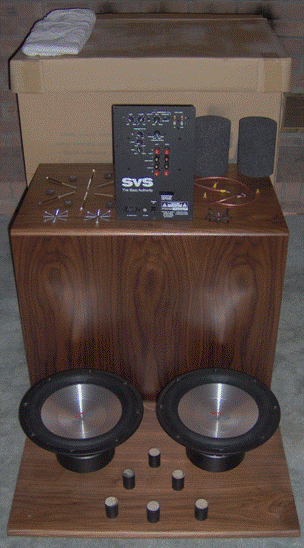

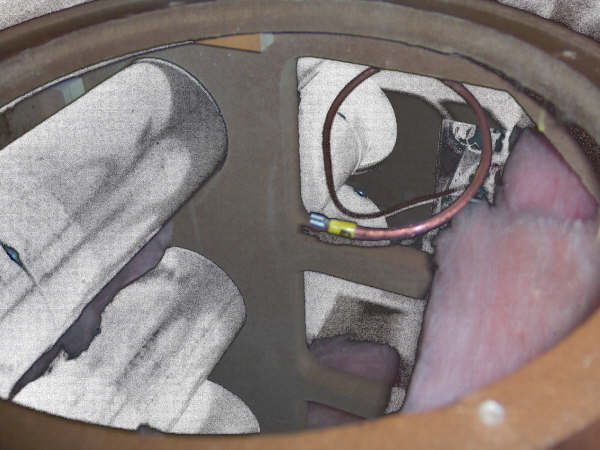

SVSound PB12-Plus/2 Hardware (Ducts not showing as they were not removable). Drivers feature aluminum cones, santoprene surrounds and strontium-ferrite magnets. Note port plugs perched in the back, right hand corner of the cabinet top. Beneath the drivers is the cabinet base plate.

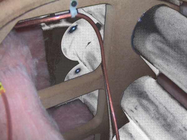

Both Photos: System flipped upside down, drivers removed. Top photo: looking aft, towards power amp. Note internal cross bracing also serves to brace the internal duct work. Bottom photo: Looking forward, note port flaring, heavy gauge internal wiring and thickness of front panel & internal bracing.

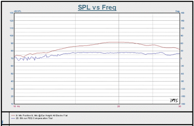

In the end two candidates (one, about half-way back along the west wall of my listening room, the other about three-quarters back along the same wall next to a sofa) emerged as frontrunners: I settled for the latter, position that minimized the visual impact of the system. Once placed, I followed the set up procedure provided by the manual. After about two hours of careful listening - and judicious use of the phase, crossover and paraEQ features sported by the system - I arrived at a settings mix that sounded very well tempered. (See Figure 13 for a before/after PEQ).Over the following next few weeks I did a lot of recreational listening, occasionally tweaking a setting or two until I was satisfied I had the sub performing at its best. Then the critical listening begin. It should be mentioned in passing that all listening tests were done using the PB12-Plus/2 processors (crossover, PEQ, etc) were used. No other processing upstream of the sub was used.

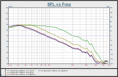

At first, the piano sounded a little too warm in the 80 Hz region, though it wasn't bad for a start. Tweaking the crossover setting cured that problem: lowering the LP crossover point to around 60 Hz brought everything into proper perspective. The PB12-Plus/2 handled that easily enough, though I've seen other subs fall down in the face of this particular challenge.
