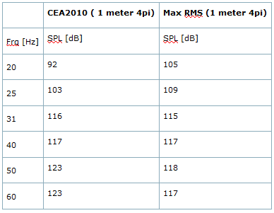

Revel Rhythm2 Measurements
CEA2010 ( 1 meter 4pi)
Max RMS (1 meter 4pi)
Frq [Hz]
SPL [dB]
SPL [dB]
20
92
105
25
103
109
31
116
115
40
117
117
50
123
118
60
123
117

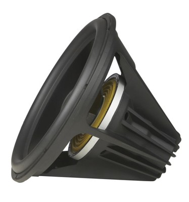

Revel Driver
Revel Rhythm2 18" Subwoofer Driver
The Revel Rhythm2 sports a dual voice coil 18” aluminum cast-frame driver powered by two amplifiers with a total of 2,000 watts RMS (4,000 watts peak). The driver itself has a 4” diameter voice coil and approximately 1” Xmax, which is pretty big huge. Combine the powerful amp, large driver, and long Xmax and you end up with the ability to hit over 115dB and a -3dB point below 20Hz (at lower power levels). Unfortunately, the marketing material leaves a few unanswered questions about these ratings, like at what frequency can the sub hit 115dB and what exactly the -3dB point is. So, we reached out to Harman Audio and got some answers. When in "Normal" mode the -3dB point is 20Hz, but in "Extended" mode that drops down to 16Hz. We also learned that the Linear Xmax, as stated above, is approximately 1" (non peak-to peak), while the mechanical Xmax is 1.7" (not peak-to-peak). The available marketing material available simply says 1.7" Xmax, where it should more accurately say 1.7" Xmech.

1m 4pi = 2m groundplane, Measurements Provided by Harman

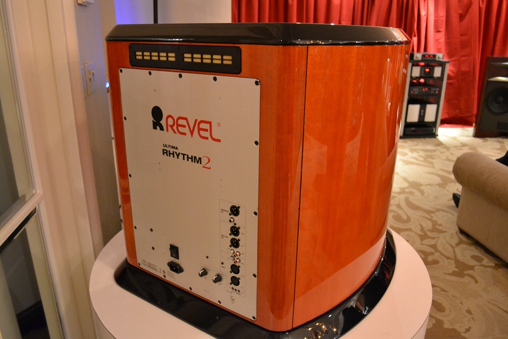

The enclosure measures 24.6” H x 27.9” W x 28.1” D and the total weight comes in at a hefty 177lbs. The cabinet itself has a 1.5" thick baffle, is curved on the sides, and has a beautiful glossy finish.  There is no servo control in place, but there are protection circuits. The build quality and driver compliment are certainly impressive, but seem a little lacking for a sub in its class. Did we mention MSRP is a blistering $10,000? But let’s take a look at some of the features before making a final judgment.
Revel Rhythm2 Rear View

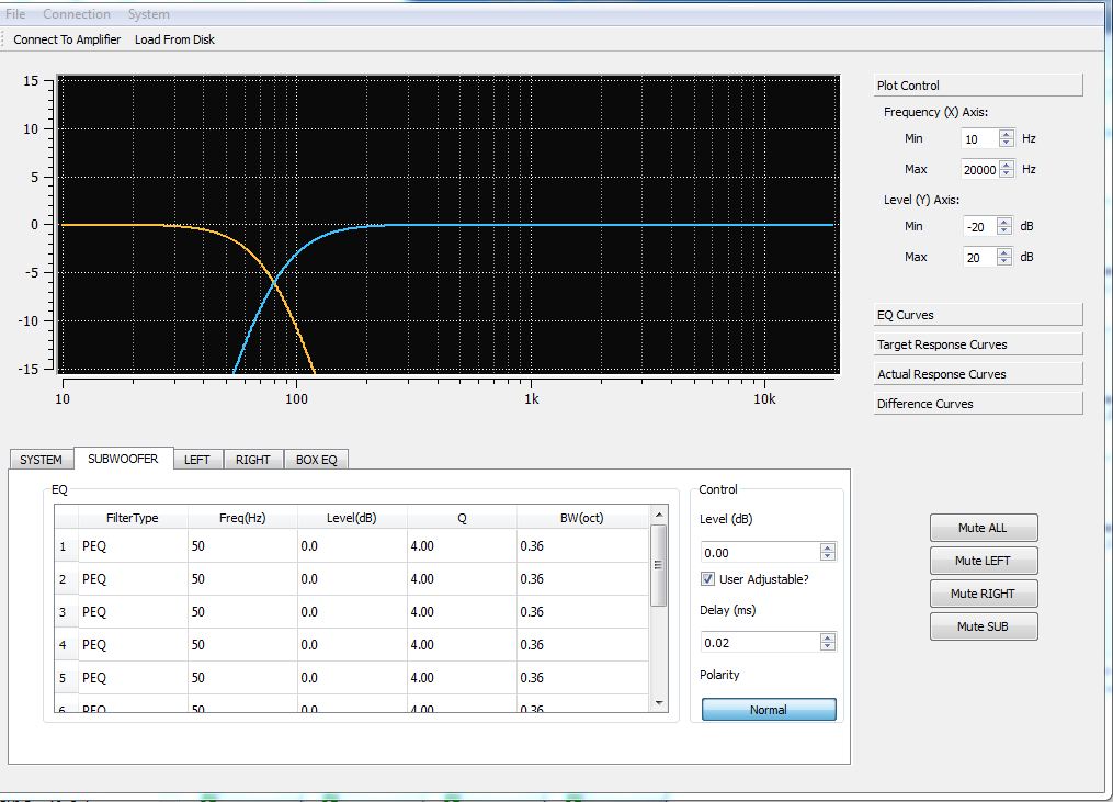

One of the big highlights of the Rhythm2 is the optional setup via PC and extensive EQ options. Typically, most of the settings on a subwoofer are configured via controls on the back panel, but the Rhythm2’s advanced adjustments are done using a computer. Revel's LFO, or Low Frequency Optimization, software allows for adjustment of delays (true delays, in contrast to most phase controls), high/low pass filters, volume, and EQ. On the back panel you will find a set of RCA and XLR inputs and outputs for your main speakers. This is because the Rhythm2’s EQ has the ability to handle crossover and EQ settings for your speakers, as opposed to setting them in the receiver. Using the subwoofer's processing power you can EQ up to 10 different room modes from 20-400Hz, whether the bass is coming from your speakers or the sub. You can also choose different slopes and high pass filters for the sub and main outputs. By adding the extensive EQ options Revel allows users to integrate the Rhythm2 with their main speakers much more seamlessly than might otherwise be possible. Below is a screenshot of Revel's LFO software, which is quite full-featured.
HK LFO
Low Frequency Optimization (LFO) Software

greatdavide;946614
So I'm assuming a mic is included too? Or how does the software know what to correct? Do I have to bring in my measurements from another program and iteratively come to the best solution?
A quote from the preview on Stereophile.com:
Voecks recommends using the Apple iPad-based “Audio Tools” application from Studio Six for set-up, which has very high resolution, and includes a mike and preamp/power supply. One then sends the data from the Audio Tools software via WiFi to the owner's PC running the Rhythm 2's software. By selecting a target curve, and manually adjusting parameters for the subwoofer and main speaker, one can achieve optimal balance between sub and satellites, set the delay for the subwoofer, and equalize not just for one specific spot in the room but for a wider area using 10 virtual parametric equalization sliders in software. The proof of this concept was the hugely powerful bass output that was solid, dense, and exhibit tremendous room lock, vibrating everything that was not tied down. He played Yim Hok-Man's recording of "Poetry of the Chinese Drum" which features explosive drum beats. The organ from Rutter'sRequiem ("A Gaelic Blessing") was balanced and powerful.
So, no, the Revel sub does not come with a mic, and, yes, you apparently need another program to feed the Revel software.
