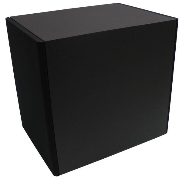

For those who may not be familiar with the brand, Power Sound Audio is well positioned as a rising star in the subwoofer industry. Co-owners Tom Vodhanel and Jim Farina are known as veterans of SV Sound, Tom actually having been a co-founder and the "V" in SVS, while Jim was involved with their R&D. One of Power Sound Audio's original offerings, the XV15, has also been reviewed by Audioholics and found to be an excellent performer in its segment. In addition to the XV15, Power Sound Audio had also originally released the XS15, a 15" sealed box subwoofer, and the XV30, a monster ported sub with dual 15" drivers coupled to a 750W RMS BASH amplifier.

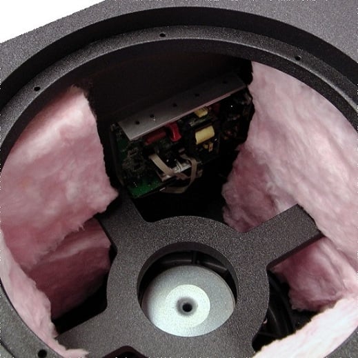

Power Sound Audio's newest offering, the XS30, is the big brother to the XS15. There is a lot to be excited about with this new subwoofer. The XS30 is equipped with a pair of dual opposed 15" woofers which can deliver two inches of peak to peak throw; bluntly, the XS30 can move a heck of a lot of air, which is important for delivering prodigious output levels and digging deep. Next on the check list is a 725W RMS/1450W Peak Bash amplifier sporting DSP (digital signal processing) control, soft limiting protection, and <1W standby mode among other niceties. The cabinet is of course not skimped on, with 1.75" thick MDF driver baffles and 1" thick walls, as well as a brace to keep the enclosure free of unwanted resonances/vibration, which consequently the dual opposed design should also help with.
 XS30 Bracing
Power Sound Audio XS30 Interior View
Judging by the build quality apparent in this picture, it’s fair to expect the XS30 will pass the knuckle rap test with flying colors.  Of course, a lot of heavy hitting hardware isn't the only thing to like here. Like all Power Sound Audio subwoofers, cabinet construction and driver assembly are done in the USA, and the XS30 is covered by a comprehensive 5 year transferrable warranty. These are perks you won't find just anywhere; most manufacturers are happy to warrant a driver for 5 years, but few are willing to back the amplifiers for such a long period of time.
