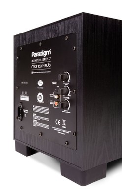

Glancing at the back of the SUB 12, you'll find volume, phase, and crossover knobs. The USB port is used for the Perfect Bass Kit and the PT-2 Wireless Transmitter (obviously, not at the same time). While there are RCA inputs, we were surprised that Paradigm didn't include speaker level inputs. This means they are expecting this system to be used with the crossover of an A/V receiver and not with satellite speakers running "through" an internal crossover. We were also disappointed that only a black ash finish is available (since they didn't specify, we're guessing it is a vinyl wrap). But is it really does reach down to 16Hz, all will be forgiven. Just as soon as we put the pictures back on the wall.
