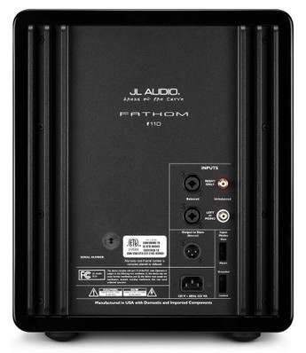

JL Audio Fathom f110
  • Product Name: f110
  • Manufacturer: JL Audio
  • Value Rating: StarStarStarhalf-star
  • Review Date: June 22, 2009 23:16
  • MSRP: $ 2,100(satin black) / $2,200 (gloss black)
Specifications
Enclosure Type:                               Sealed
Driver:                                             Single 10-inch (nominal diameter)
Frequency Response                       (Anechoic):        27 – 111 Hz (±1.5dB)
–3 dB at 25 Hz / 120 Hz
–10 dB at 19 Hz / 155 Hz
Effective Piston Area:                      60 sq. in. / 0.0387 sq. m.
Effective Displacement:                160 cu. in. / 2.6 liters
Amplifier Power:                           900 watts RMS short-term
Dimensions (H x W x D):              15.64 in x 12.92 in. x 17.27 in.
Net Weight:                                    67 lbs.
Cabinet Finish:                        High-Gloss Black or Satin Black
  • Tactile response and slam defies its diminutive size
  • A pair of f110s have the ability to transform your systems overall performance to new heights
  • Beautifully crafted with superb fit and finish
  • Premature high frequency rolloff above 80Hz
  • Available only in black
  • Expensive
