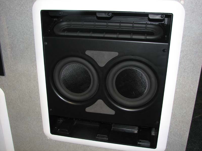

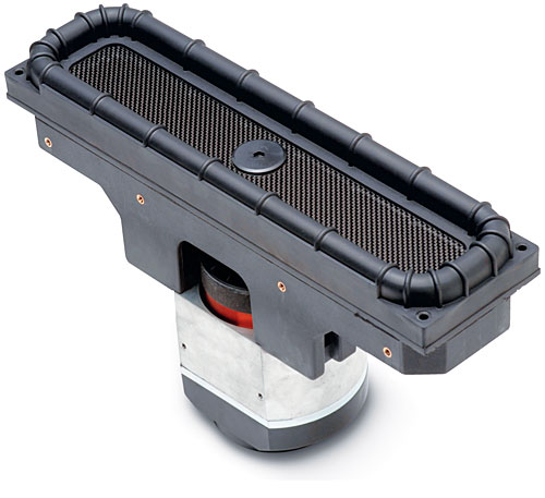

As I was walking out of the Paradigm booth, I noticed display area showing off a picture of a new in-wall subwoofer that made me take a second glance to ensure I didn’t accidentally walk into the Velodyne booth.  This new prototype subwoofer appeared to be strikingly similar to an existing Velodyne unit that has been out for 2+ years.
Paradigm In-wall Velodyne driver
Paradigm driver (left pic)   Velodyne driver (right pic)  you decide
Mark Aling, Marketing Director of Paradigm assured me that this driver was in fact their own and although it has a similar appearance to a Velodyne one, Mark explained to me that vibration canceling design’s of in-wall subs have been a popular design feature for a number of years.  We look forward to seeing how this product progresses.

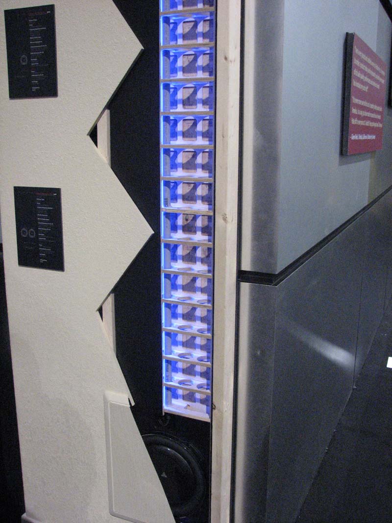

Seems B & G also has something in mind for InWall...
Interesting design...
There are 12 coffee can sized driver housing lined up facing each other and porting out that long slot you see. It takes four of these units in total to get the THX seal of approval during install, but the price of $7,000 is actually pretty reasonable compared to a couple of $3,000 discrete subs.
