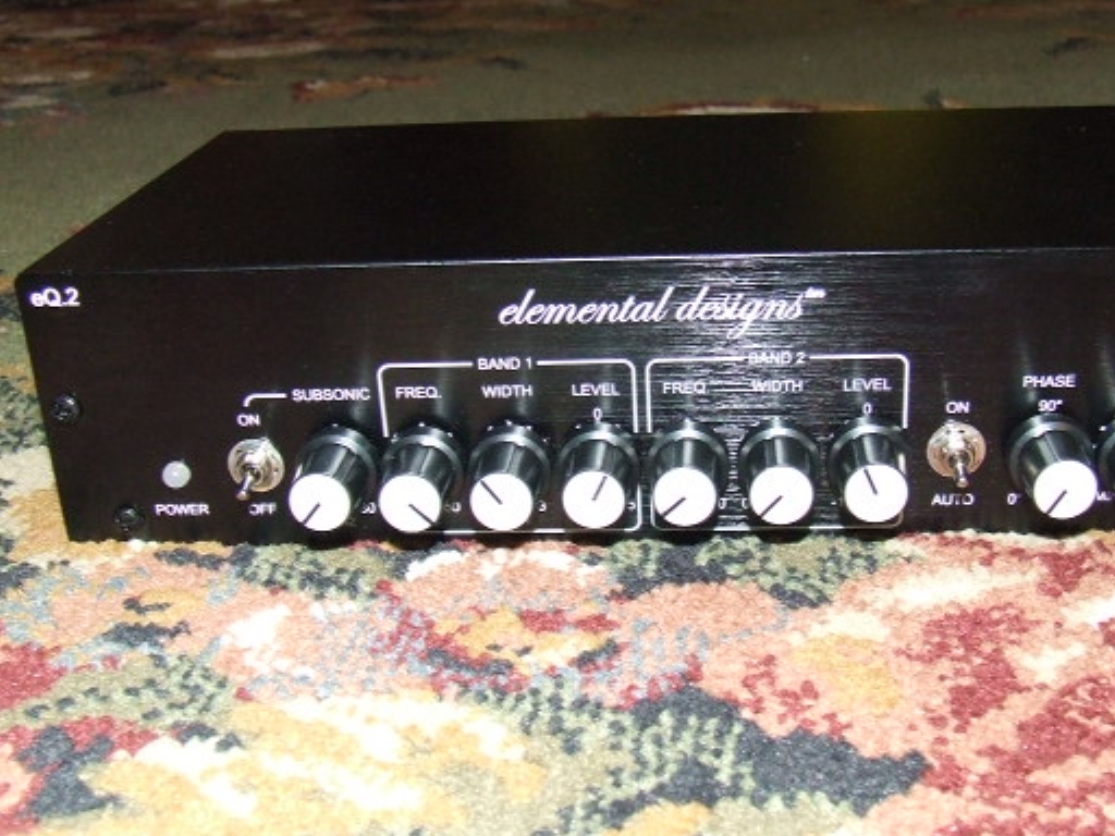

As far as the eQ.2 performing, it worked as advertised, cutting levels at frequencies and over bandwidths as specified by the user. Where the eQ.2 could be a bit better in actual use is the small knobs coupled with wide ranges that make settings imprecise.
After determining what settings I needed to flatten my room bass response, I found it difficult to make those setting. Any setting between the control boundaries was by eye using tick marks that did not always correspond to the ranges in a simple, logical way.
Assuming linear behavior of the 7/16” knobs with a rotation range of about 300 degrees:

Slight adjustments in the rotation of the knobs would leave me overshooting or undershooting the desired setting value. The available rotation would be put to better use with wider angles for adjustments, for example with the width, using 1/6th (0.167) octaves to 1.0 octave over the same knob rotation to allow control that is more precise. Another way to improve the difficulty in making settings would come from simply using larger diameter knobs:

The frequency knobs, for example are less than 1/32nd inch per Hz. Doubling the diameter to an inch at least gets us to 1/16th inch per Hz and at least onto a standard ruler.
On top of this, the tick marks themselves are actually hidden behind the knobs, in that they are arrayed around at the same outer radius as the knobs. So, one has to get in close with good lighting to actually see them to make adjustments using the marks; a potential problem if the eQ.2 is installed in a tight equipment rack or other out of the way location.
