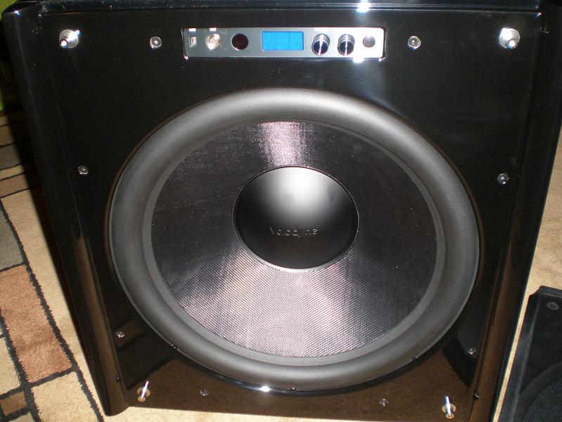

Initial thoughts after getting the DD18+ unpacked and looking through the accessory pack contents for a few moments? This is a very high quality unit here, man that is a nice finish and finally…Where to begin? The DD18+ came in the black gloss ebony finish that was really pleasing to my eyes. That particular finish is very dark and mirror polished, but you could still see wood grain underneath on close inspection. Everything about the DD18+ was constructed well, solid feeling and the curved side panels give it a streamlined appearance. The DD18+ is a good sized subwoofer that is not going to disappear easily, but it does have a very classy and high tech look to it. It reminded me of something that you would see at Bruce Wayne’s place.

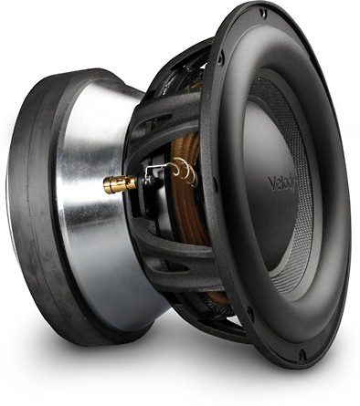

The Velodyne DD18+ design utilizes an 18” driver in a sealed enclosure with a 1250 watt amplifier and includes a remote control for adjustment of output or EQ presets to suit your tastes without even having to leave your seat. This is already a recipe for quite the subwoofer, but the DD18+ doesn’t stop there and also utilizes Velodyne’s trademark active servo control which uses an accelerometer to monitor the voice coil position and provide adjustment to correct the output of the system and lower distortion. Velodyne claims this happens over 3000 times per second and the result is less than 1% THD during typical use. The DD18+ also houses a powerful DSP system which allows it to connect to a computer, measure and EQ its own response, or modify and save user presets for recall later. The DD18+ may also EQ itself with no need for connection to a display if there is none available to connect it to.

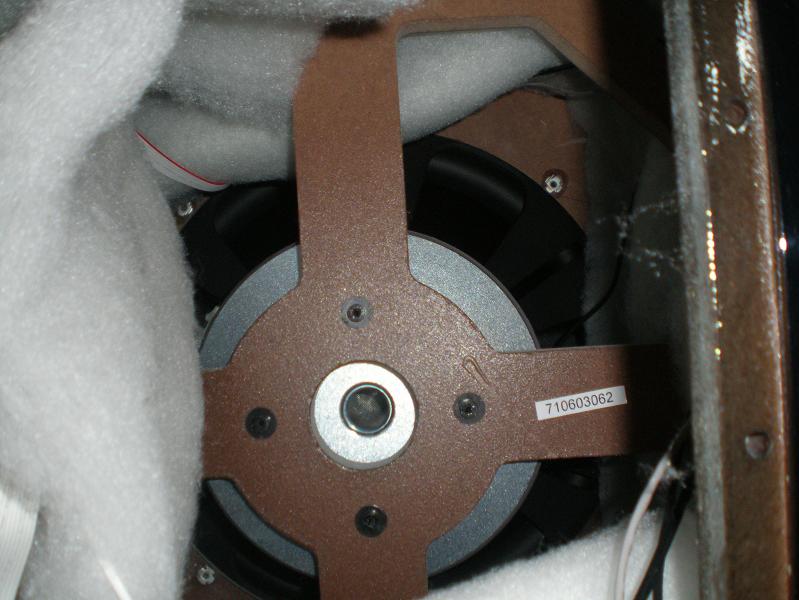

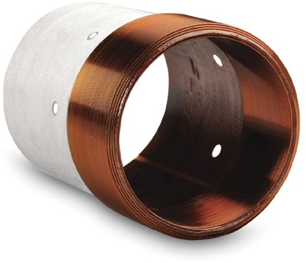

Usually I would have removed the driver for pictures and inspection, but I did not remove the DD18+ driver due to it being a rather involved affair including removing the amplifier, disconnecting the driver and servo sensor from the amplifier, unbolting the driver motor from the enclosure bracing internally, removing the grill and front fascia, removing all of the driver bolts, etc. I contented myself with inspecting the driver while it was still attached to and housed in the enclosure. Needless to say it is a high quality and robust unit. The motor is very large and heavy. It looks to be built on 2 roughly 9” diameter ceramic slugs and a very large and tall top plate. There is also a roughly 1” pole vent with a screen to catch debris before they enter the gap. The driver uses a 3” nominal voice coil in what appears to be an underhung arrangement where the voice coil is short and the top plate and magnetic gap are tall. This is a way to improve driver linearity with stroke by keeping the motor force more constant with respect to voice coil position and thus reduce harmonic distortion. The cast aluminum frame used is sturdy and well ventilated. The cone is light but stiff and strong. I am a fan of Rohacell composite cones for this reason, not to mention that they also happen to look great. The spiders are generous in size and the surround is as well suggesting that the driver is capable of plenty of stroke for demanding low bass transients. This is a very high quality driver.

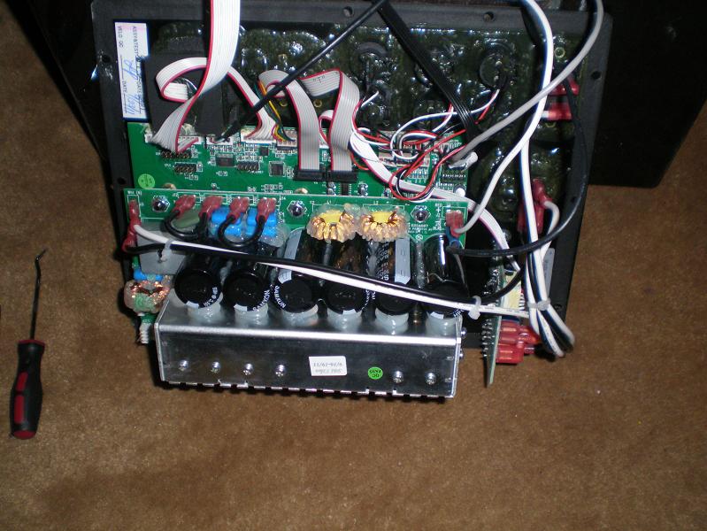

The amplifier itself appears to be of similar high quality and connects to the front panel control unit via a ribbon cable. Six large reserve capacitors were in evidence on the top circuit board as was a small aluminum heat sink which indicates that this is the power section. Another larger circuit board is mounted below the power section. During testing and use the amplifier face never got much more than warm to the touch implying that it is a very efficient design. Also the amplifier contains a simply staggering amount of input and output connection possibilities. Everything from balanced XLR ins and outs, to 12v trigger, to speaker level inputs, unbalanced RCA, serial ports and even an Ethernet port. There is even a USB port on the front panel. No one can accuse Velodyne of limiting your options that is for sure.

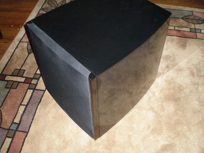

The enclosure of the DD18+ under review was a beautiful ebony gloss black finish in which you could still see wood grain if looking closely. Internally the enclosure has a very large window brace in the center which the driver motor is also anchored to with bolts. This ties every major panel of the enclosure together except for the back panel which houses the amplifier. There is also a generous amount of poly fill stuffing inside of the enclosure behind the driver and on the walls. During testing and use I noted no cabinet resonances or audible issues related to the cabinet even at the loudest drive levels. It is very solid and inert.

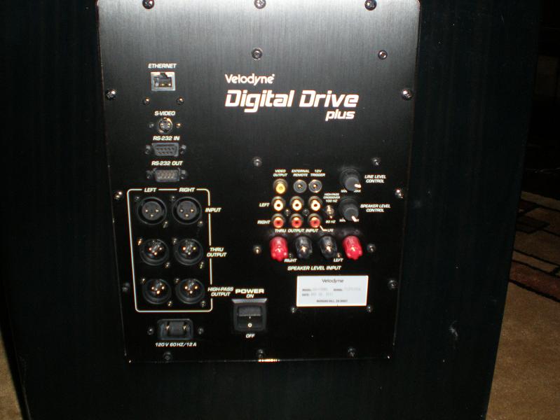

To recap, for all Velodyne Digital Drive Plus sub owners, regardless of sub size, there are three sets of inputs on each sub. One set for speaker level inputs, one set for single-ended line level, and one set for XLR line level. The speaker-level inputs and the single-ended inputs have dedicated input level controls, so input stage overload is not a factor, but the XLR inputs do not have level controls.
For those of us driving the DD Plus subs with full-range balanced outputs from our pre-amps, input overload is a very real factor. As cjwhitehouse noted, many owners running XLR cables are using sub volume levels of "5" to "10", when Velodyne ships the sub with a default of "30". I called Velodyne and asked if there was an XLR input sensitivity fix, and they never responded.
