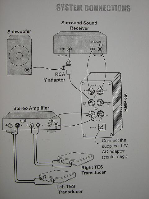

The TES-100 kit can be installed and terminated in different configurations. The most common approach would be to use an RCA "Y" splitter from the LFE output of your receiver or pre-amp and connect one RCA Interconnect from the splitter to your subwoofer and the other to the BMP-3S LFE input. Then you would connect a stereo pair of RCA interconnects to the A200 amp and then finally connect speaker wire from the A200 to the TES-100's. Another approach if your subwoofer has a bypass LFE output would be to daisy chain the BMP-3S pre-amp and then follow the same procedure as above for the rest of the installation. The system can also be connected using your receivers right and left stereo analog outputs, Aux or Tape monitor but we only recommend this type of configuration as a last resort.

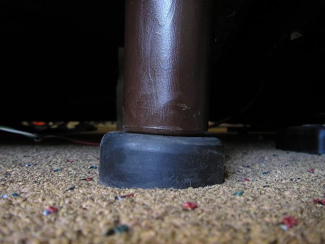

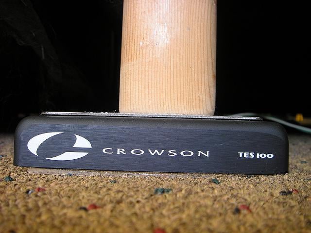

The TES-100 transducer is placed under the leg of your couch or chair and the rubber isolators are placed on the remaining legs to isolate tactile response from the floor surfaces. One thing to note that we found is that if you have sectional sofa that has many pieces it may be necessary to purchase more of the optional isolators because the pieces with the transducers and isolators installed will be raised higher, making the sectional look out of alignment.
Another thing we noted is that the TES-100 stereo kit ships with only two rubber isolators. This makes it difficult to install these correctly in cinema recliners because you would need to use the isolators on the rear feet raising the back of the chair. When we installed them in this configuration it raised the center of gravity for the chair and almost tossed us from the seat when we leaned forward. The additional rubber isolators are available from the manufacture for an additional cost, but in our opinion these isolators should be included with the kit to accommodate all types of installations.
