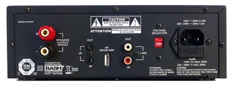

The Buttkicker Wireless Home Theater Kit comes with a wireless RF transmitter to send the signal from your receiver (or other source) to the Buttkicker BKA300-4 amplifier, an IR remote, a universal mounting plate plus an under-leg chair/couch pad with five additional rubber isolators for the other legs, and a slew of wires including an RCA “Y” adapter, 1 m RCA male to male cable and a Speaker Level Interface Adapter for connecting to your home theater or gaming system (whether “pre-out” powered subwoofer out, “passive” subwoofer out or simply a “line-out”) and 20’ of 14 gauge speaker wire with banana connectors. This is a one stop kit that has everything you need and a few extra things you probably don't.

It should be noted that "wireless" means that you don't have to run wires from the receiver to the Buttkicker amp. It does not mean completely wireless. The amp still needs power and is generally pictured behind the couch though there is no reason it couldn't be placed somewhere else (like under depending on the clearance). The transducer can either be mounted to the frame of the chair or couch with the universal mounting plate or placed under the leg. The nice thing about the additional rubber isolators is that it allows the couch to shake without transmitting those vibrations to the floor (and to your neighbor's dishes).
