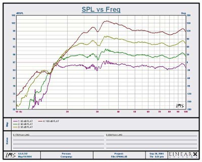

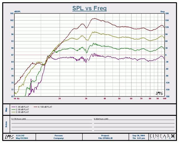

While subjective commentary can give good insights as to how a product performs and how the listener/reviewer perceives its performance within the confines of their listening environment, the proof is in the pudding so to speak.  This is why it's always good to have some supplementary measurements and analysis to see if those measurements are audibly perceivable and correlate to what we are hearing.  Since frequency response can demonstrate the product bandwidth or tonality, this is a good start.  To go one step further, one must test this frequency response at various power levels to determine power bandwidth uniformity and freedom from excessive compression.  With that in mind, we ran some frequency vs SPL tests on the EP600 at various output levels to validate Axiom's claim quoted below:
"Our DSP system wants things to go smoothly all the time - no bumps in the road. Using a digital roadmap, the XLF controls every frequency from 17Hz to 100Hz, never deviating more than 1.5dB through this entire range."
EP600 SPL vs Frequency Plots
The bottom purple trace- indicates 17Hz to 100Hz +/-1.5dB @ 85.5dB SPL
Note 16Hz at 85.5dB is the threshold of audibility for such a low frequency
System linearity remains excellent as power is increased though the lower frequencies handled by the port are increasingly attenuated. In an acoustic suspension system this type of curve would appear to signal power compression. Without an audible reference with this ported system, however, it is impossible to know how the system actually sounds, that is, if extraneous noises are coming into play, as the power levels are increased.  I personally didn't hear any problems with audible compression in my listening tests.  In fact the EP500 and EP600 appeared to have enough headroom to rumble the foundation of the Colquhoun house.
It appears that the driver-port transition area is at 30Hz with the transducer being equalized approximately +4dB at 33-34Hz. The ultimate low bass capability of the system has been extended downward below 30Hz by the use of a large enclosure with a well designed port. The system is thus able to achieve a free air roll-off of ~18dB/octave which should allow better-than-average room coupling of extremely low frequencies at the cost of ultimate system (broad bass-band) output.

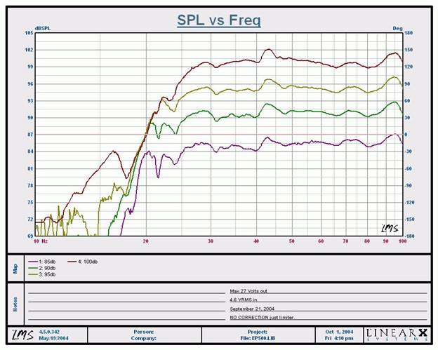

Plotted below are the measurements for the EP500, again done in a 4pi environment 1 meter away.
EP500 SPL vs Frequency Plots
The bottom purple trace- indicates 20Hz to 100Hz +/-1.5 dB @ 85dB SPL
As you can see the EP500 does have a few dB less output at the lower frequencies, and given the smaller box size and slightly less amplifier power, will not play quite as loudly as its bigger brother.  However make no mistake, these subs have a well extended low end with ample power.
Thus the Axiom Audio claim about maintaining +/- 1.5dB 17Hz to 100Hz for the EP600 and +/-1.5dB 20Hz to 100Hz for the EP500 through the entire range is in fact true providing that the SPL output is kept to under 92dB (anechoic) which equates to about 103dB or so in a real room.
