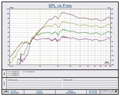

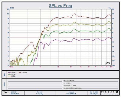

Of course the Axiom engineers didn't just end it with a great digital amp design.  They went one step further and implemented Digital Signal Processing (DSP) with a custom-designed "algorithm" tailored around the specific driver to linearize the response across the usable bandwidth at all power levels. This was to automatically correct frequency response deviations.  The DSP also serves as a limiter to prevent the amplifier from exceeding its output limits and going into distortion. It also limits the subwoofer driver from over-excursion to minimize excessive distortion and cone break-up.   The system is designed to minimize frequency response deviations to +-1.5dB (in anechoic environments) within the full bandwidth of the product.   More on this later.
