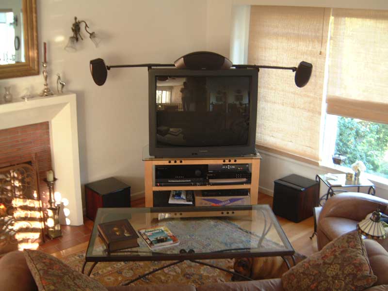

So here we are today, faced with a stunningly beautiful subwoofer, that, because of its single-band parametric EQ can be placed anywhere in the room you or the significant other decide, (except, of course, a null). It's priced well and it's flat response bass capabilities just await music and bass lovin' Audioholics who are willing to put in a couple hours up front to get clean, flat, low end like they've never experienced.
Also noteworthy from AV123 is that they listen and pay close attention to us at Audioholics. When AV123 heard that I wanted to use two of their subs for my first full length speaker review they immediately put a two-fer deal up on their site. Buy one UFW-10 at the normal retail of $599 or two for the bundled price of $999!
