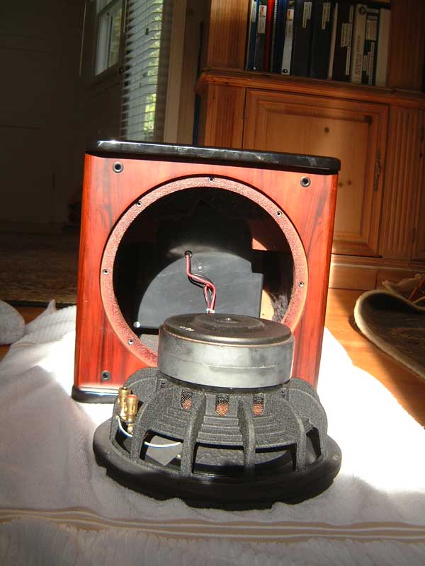

UFW-10_AV123S_097.jpgThe UFW-10's 13 pound woofer is built within a heavily ribbed die-cast aluminum frame. It is secured to the MDF enclosure utilizing 8 machine screws clamping into steel T-nut-style inserts. Note that the woofer has a double-stack magnet structure but no shielding so caution would be advised in placing this sub close to a CRT (tube TV).
The woofer cone of this sub is a hybrid sandwich of a black-anodized aluminum, single-dish diaphragm bonded at the back to a heavy pulp substrate. This clever and expensive construction gives the non-bending "perfect piston" performance of metal while the pulp substrate damps any high frequency ringing effects of aluminum. At the same time the combination of the two materials adds substantially to the moving mass of the system which usually allows for better low end performance.
The cabinet's front baffle is just under an inch in thickness measuring 22mm (0.86"). The rest of the five surfaces appear to be closer to 18mm (0.70"). There is also an 18mm top-mounted side-to-side brace. Structurally a good idea given the pressure generated in this sealed-enclosure subwoofer.

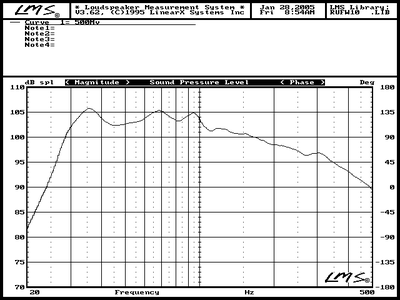

UFW-10_AV123S_028_sm.jpg To get decently accurate measurements subwoofers need to be tested outdoors. I used the back parking lot and the LMS (Loudspeaker Measurement System software program by LinearX) of Speaker City USA in Burbank, California. Tested outside, subwoofers can be measured very accurately using the ground plane measurement technique as seen in the photograph.
To protect the UFW-10's cabinet I placed a heavy blanket down on the asphalt. The AV123 sub was laid on its side on top of the blanket. One meter away the LMS microphone was placed on the other end of the blanket. Setting of the rear amplifier controls were as follows:

  With the controls set as shown above I adjusted the LMS to input 1 volt to the UFW-10. The reading I got indicated that the either the sub's input was overloading or the transducer was compressing under power. So I reduced the voltage and tried again. As I reduced the voltage input levels the UFW-10's low frequency response began to extend lower and lower. At 500mV input this little marvel recorded a frequency response of 35Hz to 100Hz at 104dB SPL! From the curve I would guess that at least 3dB of equalization boost, centered right at 35Hz, has been dialed in. This is normal practice during a subwoofer's design stage. It is this EQ boost which allows such a small-cabinet 10" 500-watt sub to extend in frequency as low as it does.

In the case of the UFW-10, we've already used the ground plane measurement method so we're seeing the 6dB "boost" that wouldn't be observed in a 4pi anechoic chamber measurement. This is an honest measurement. Place your own UFW-10 on a floor, away from walls, and this is the performance you can expect. If we drop another 4dB down from our 35Hz figure we can get to the 10dB down point which competitor's marketing specs may use. For the UFW-10 that -10dB point is around 29Hz. My take is that for a subwoofer of this very small size this is excellent performance indeed.
