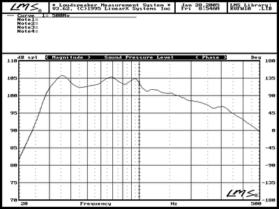

Rated 25Hz -150Hz ±2 dB   Measured 30Hz - 108Hz ±1.75dB

  • Pre-amp section overloads if input exceeds 500mV RMS causing low frequency response non-linearities.
