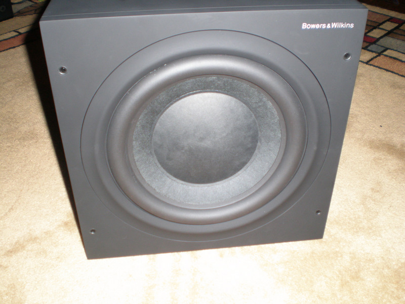

The ASW 610XP is tiny! At 12.8”x12.8”x14.8” it occupies barely 1.4 cubic feet of volume in a room and weighs a mere 34lbs. The ASW 610XP takes the title of smallest and lightest subwoofer I have ever tested away from the Klipsch SW-311 that was reviewed here a short time ago. The finish is the first of its kind that I have seen on a speaker. It is a dark gray color which is called matte black by B&W. It has an almost rubbery or tacky texture to it. Sort of like the rubber that you might encounter on some iPod or cell phone cases. It is soft to the touch and creates a lot of traction or surface friction. I really like the finish but the one thing that I noted about it is that any moisture will leave visible marks on the finish that do not just wipe off. Even having some oil on the skin of your hands when you move the sub will produce this. You might think “Why would I be touching it or moving it more than once or twice?”, or that you don’t plan to sit drinks on it and that is probably true but it was something that I noted. Either way it is a different finish from the usual. This is one sub that will be very easy to find a place for or move when needed and it easily ace’s the test for spousal acceptance factor.

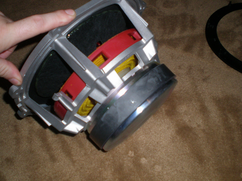

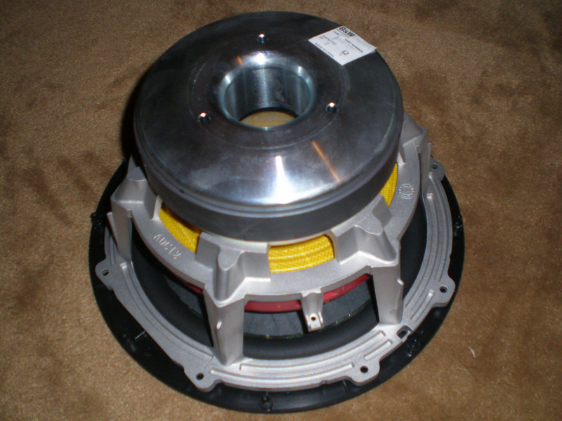

 After popping off the trim ring, which covers the frame and mounting screws for the 10” driver employed in the ASW 610XP, so that it could be removed from the cabinet, I could see that it is a rather high quality unit. B&W lists the cone as a Kevlar, paper pulp and resin mixture. The surround is a rubber half roll and the frame is a very open, six spoke, cast aluminum design with an oddly shaped mounting flange. The driver makes use of 2 generously sized spiders separated by a plastic spacer. The cone also has venting underneath of the dust cap. The motor utilizes a single roughly 6” diameter, 1” thick ferrite magnet sandwiched between the top plate and the back plate. The back plate is moderately bumped to provide voice coil clearance and features a large 2” diameter pole vent with 3 smaller vents which are probably for the gap. The voice coil appears to be a 3” nominal diameter and the leads are sewn into the top spider. This unit exhibits very nice parts quality and attention to design.

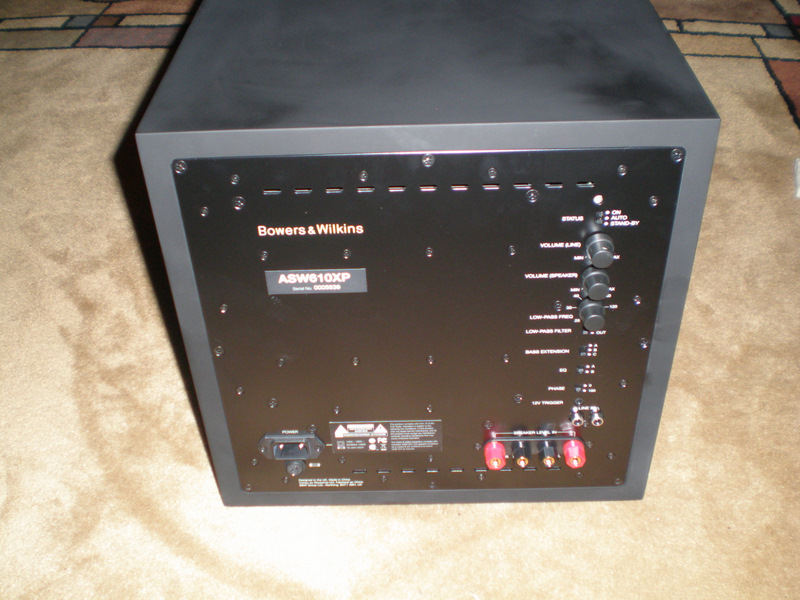

The amplifier for the ASW 610XP is rated at 500 watts and is listed as class D. It occupies virtually the entire back panel of the enclosure and has controls for most of the functions found on a typical powered subwoofer: Phase, gain, low pass, auto/on/standby, etc…Plus a few extras, namely the switches to control the EQ contour and extension settings. When I removed the amplifier from the enclosure I noted that the amplifier has a sealed chassis and also has its own sub-enclosure within the main enclosure. I did not take the extra step of removing the chassis cover from the amplifier to get internal pictures of the amplifier components and circuit layout. During the review process and measurements session I would occasionally check the amplifier to see how hot it was getting and it never seemed to get much more than warm to the touch throughout.

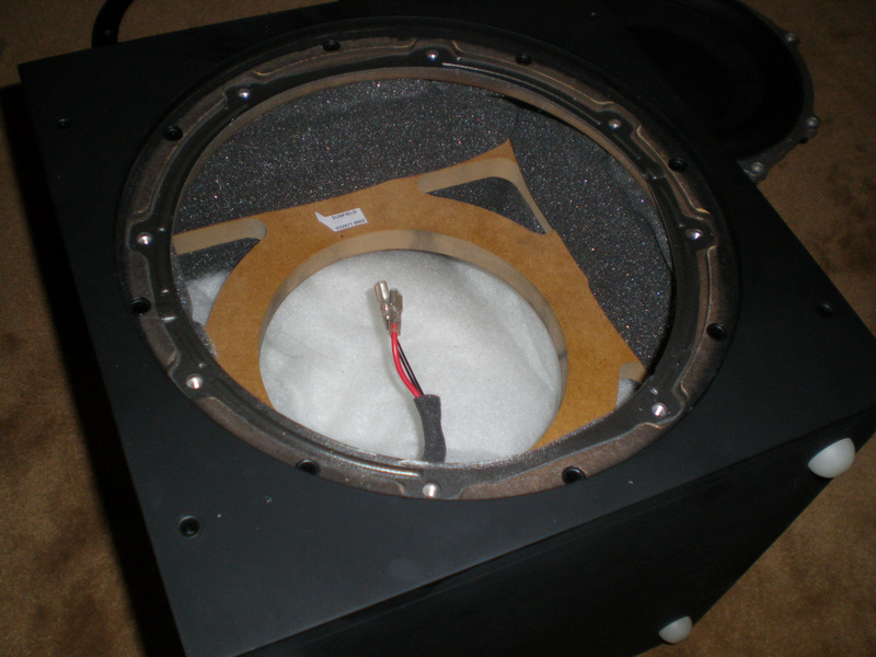

Construction of the ASW 610XP’s enclosure appears to be ¾” MDF. There is a large window brace in the center of the enclosure that appears to double as a brace for the motor of the driver and also a full panel further back in the cabinet to separate a chamber for the amplifier. There is dampening foam on top, bottom and both side walls internally. There is also a large chunk of poly fill directly behind the driver. All of this combined with the very small enclosure panel sizes results in a very inert and dead enclosure. The driver and amplifier are both flush mounted. The driver has a trim ring which snaps in over top of the mounting flange. Overall parts quality, build quality and attention to detail are very high.
