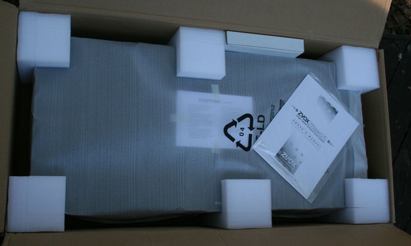

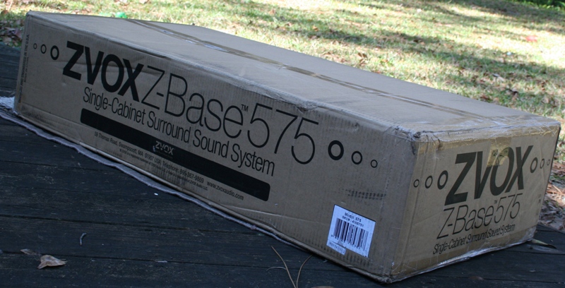

The ZVOX IncrediBase575 arrived in a large, rectangular box with foam corner caps and two additional u-shaped foam pieces protecting the long side of the speaker. There is an additional box for accessories and cables including a set of RCA cables, a power cable, and a remote. The speaker arrived undamaged and, though it was big, the box was not too hard to move around.
ZVOX_575_box1     ZVOX_575_box2

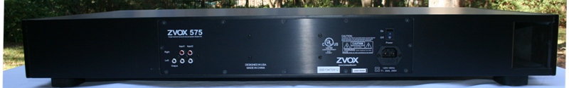

Around the back you'll find two stereo analogue RCA inputs and one subwoofer output. There is also the IncrediBase575HSD which has the same specs but adds digital connections and a few smaller models with similar analogue inputs. There is a slot-style port on the back with four rubber feet on the bottom. The front has a (seemingly) non-removable grill. Behind the grill are five, 3.5" drivers. They are positioned with three in the center and one near the edges of the box. On the bottom of the box is two downfiring 6.5" woofers protected by a metal mesh grill to provide subwoofer duties. The box itself is large and bulky but not overly heavy. While it feels sturdy, it isn't like you'll need to invite a friend over to move it. Most of the box is wrapped in flat black vinyl with the two sides in gloss black. While the black finish should meld well into a dark room, the vinyl seemed easy to mar and slight abrasions were fairly evident on close inspection. For this reason, when you are placing your display on top, we recommend you set it down rather than place it and slide to the correct location.

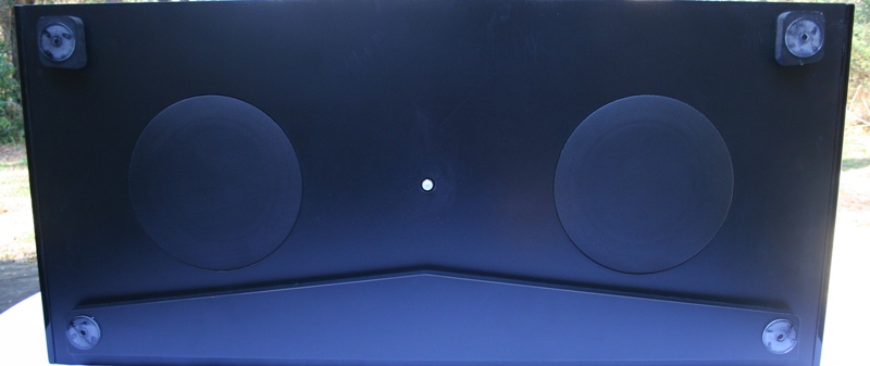

ZVOX_575_bottom

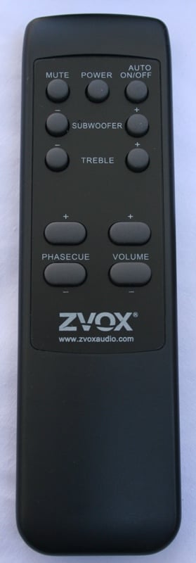

ZVOX_575_remoteThe remote of the ZVOX IncrediBase575 is very, very basic completely lacking backlighting and with uniform and bizarrely laid out buttons. At the top there are seven round buttons with four oval buttons near the bottom. At the top we have Mute, Power, and Auto On/Off. While it seems like the Auto On/Off would be better as a switch on the amp, it is included on the remote. Below those there are Subwoofer and Treble controls Up and Down that are oriented horizontally. The oval buttons at below those are PhaseCue and Volume Up and Down that are oriented in the more traditional vertical arrangement. Since you'll need light to see the remote maybe this switching orientation of the controls won't be an issue.

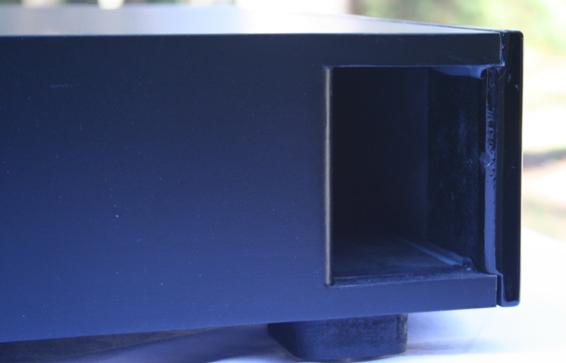

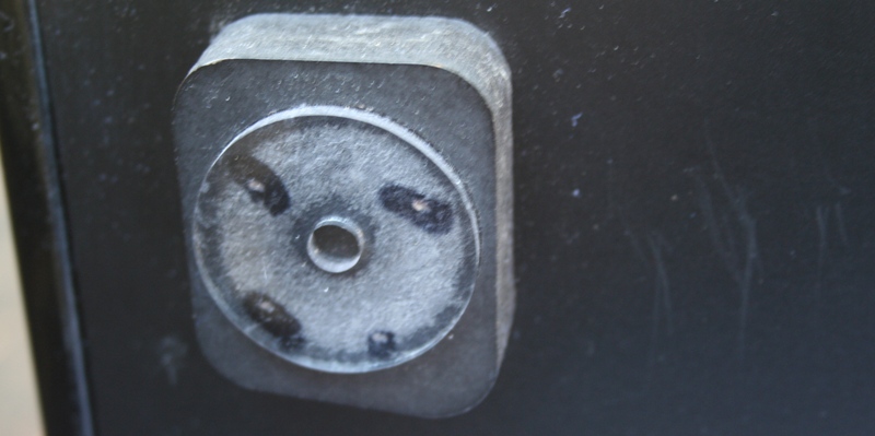

Fit and finish of the ZVOX IncrediBase575 is decent though you can notice some rough edges in the vinyl wrap here and there. Inside the port (something most people will never see considering it's location on the back of the unit) was a bit sloppy with extra glue. This does bring up and interesting design choice - the port placement. Rear ports make sense for aesthetic reasons since you don't exactly want a gaping hole facing out into your room. But a port generally needs room to breathe and the size of the IncrediBase575 really sort of suggests that it would be pushed up against a wall. We wonder if a side-firing port might not have been a better choice
ZVOX_575_vinyl     ZVOX_575_port

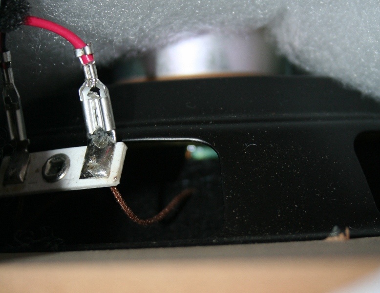

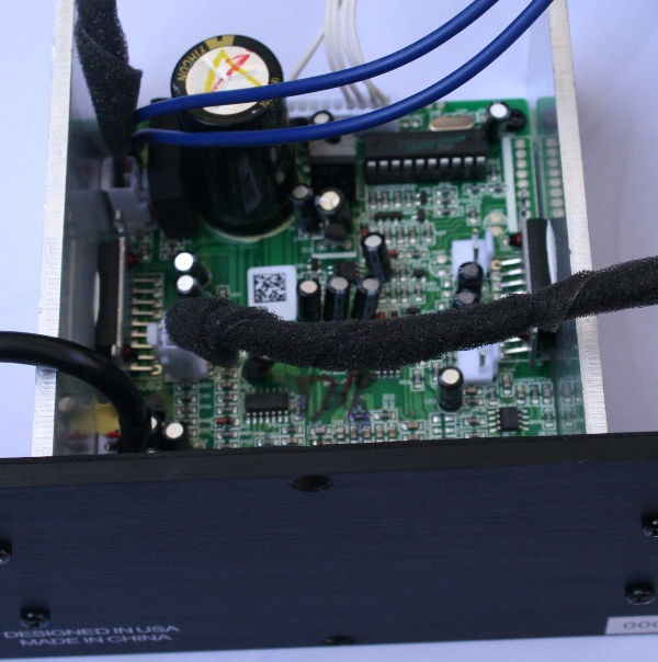

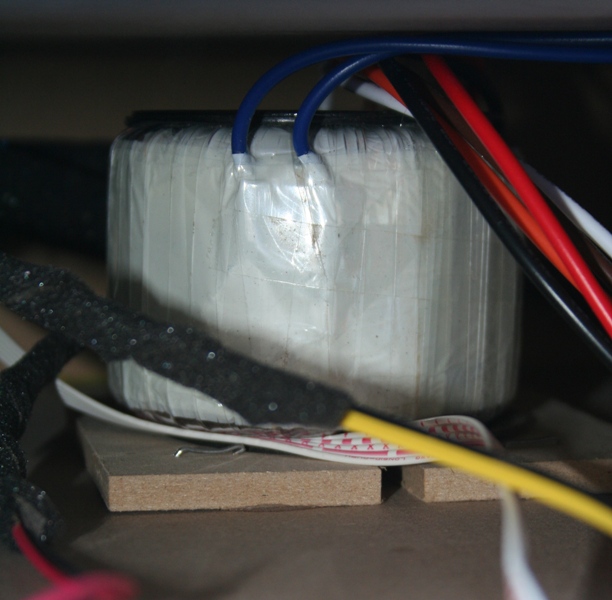

ZVOX_575_ampWe opened up the back of the ZVOX IncrediBase575 by removing the amp. It was really the only part of the unit that we could get access to. We couldn't get the grills off without risking damaging the unit. Inside, we could clearly see the backs of the 6.5" woofers and the back of the box that housed the front-firing drivers. The front firing drivers were enclosed in their own area and inaccessible. The woofers, which were clearly visible, had stamped baskets. There was a bit of polyfil in the box between the top of the box and the back of the woofers.The wiring to the drivers was wrapped in velvet tape to prevent any noise from rubbing or vibration. Their was a small toroidal transformer mounted in the center of the cabinet. The cabinet was constructed out of braced 1/2" MDF. The bracing of this box is particularly important since not only is it proving inertness to the box but also support for the display that is meant to be placed on top.
ZVOX_575_woof     ZVOX_575_power
