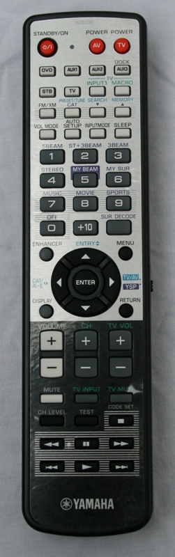

YSP-4000-remote.JPGThe remote for the YSP-4000 is very utilitarian. There are dedicated buttons for each of the inputs, surround modes, and controls. Honestly, it is like they had more buttons than they knew what to do with so they just gave everything its own. I'm all for that. The unit is extremely responsive and the remote worked well off axis from the YSP-4000. My only strike against the remote is the lack of backlighting and the fact that most of the buttons are the same shape (or similar). For instance, the surround modes are all on the numeric key buttons which are all the same size and evenly spaced. In the dark, you're going to have to find the Braille dot on the five or do a lot of counting to find the right button.

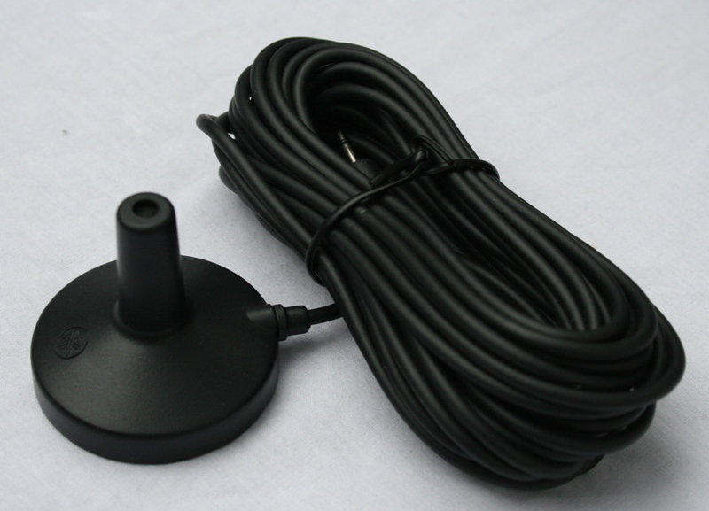

YSP-4000-mic.JPGYou've got a few different beam mode options (5-Beam, 3-Beam+stereo, 3-Beam, My Surround, My Beam) and you're going to want to test them out for yourself. 5-Beam uses the walls to bounce the sound around the back of you while the 3-Beam modes bounce it just to the sides of you. The 3-Beam is designed to expand the "sweet spot" by giving you a direct center channel with reflected front channels (left and right). The +stereo mode further accentuates the front channels while still providing the reflected sounds. The My Surround mode is different in that it provides a surround experience without reflected sound. This is how the competitors of the YSP-4000 usually present a pseudo-surround experience. Essentially, you are getting all the advantages of the YSP and the competitor's technology in one box! That's pretty cool. The advantages of the My Surround mode is that it doesn't reflect sound so it is not affected (as much) by the shape of the room but the disadvantage is that is isn't quite as convincing as the 5-Beam set up in a properly shaped room. I found that in my less-than-optimal room, the My Surround mode actually sounded better than 5-Beam.

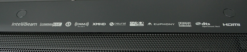

YSP-4000-top.JPGThe My Beam mode is a bit different than the others. If you are in a loud environment and you are having trouble hearing the YSP-4000, you can point the remote at the YSP, hold down the My Beam button for 2 seconds while holding the remote steady, and then release. The YSP will send out a quick couple of tones to see where you are sitting. There is a mic in the remote that will register those tones and send the information back to the unit. The YSP-4000 will then direct the sound to your location in a single channel setup. You won't experience surround, but you will be able to hear the game while all your wife's friends are yapping about scrapbooking or whatever. The problem? For some reason it shuts down the subwoofer.
