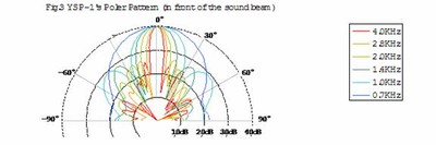

This particular cut does, however, begin to point out one of the trade-offs that evidently has been made with the Digital Sound Projector. The frequencies the YSP-1's small drivers are most capable of throwing furthest would appear to be in the 3-6 kHz range. It is this same relative frequency range that famous theater speakers like Altec Lansing's A7 500 "Voice of the Theater" used in the '40s and '50s to generate enough sound power levels out to the audience.
Back in that time, movie theater interiors were often entirely surrounded by heavy drapes. The natural bump in the 3-10 kHz frequency range of Altec's horn mid-tweeter was the solution for achieving flat sounding frequency response for most theater goers. Today's home theater is a different application. Nevertheless, this Yamaha's beam-throwing, frequency response curve is complementary to most DVDs. So the design of the YSP-1's response curve appears to have been carefully tailored for the most realistic surround effect that can be thrown furthest.

Second, in my open floor plan living room with corner placement, the YSP-1 cannot synthesize a fully round "sound bubble" like an actual set of -90º and +90º dipoles or bipoles can. This is almost an impossibility given that the sound-beam-throwing phenomena exploited by the YSP-1 depends on the ear-brain being able to triangulate a point of sound using the sound source and both ears . Once one ear is blocked by one's head, such as would be the case for a sound at ±90º from the 0º listening position the "full-round-surround" effect is much more difficult to synthesize.
The upshot of the preceding paragraph is that for the YSP-1's power and small driver size, sound "beams" can only be made so narrow and therefore project only a specific distance with a limited amount of power before the beam spreads out and loses both power and focus. The YSP-1 does, therefore, have the potential to perform even better in a smaller, rectangular room, mounted not in the corner but against one of the wall surfaces. I plan to follow up this first review with a further thoughts piece when I move the YSP-1 into my smaller, almost square home office. Stay tuned...
