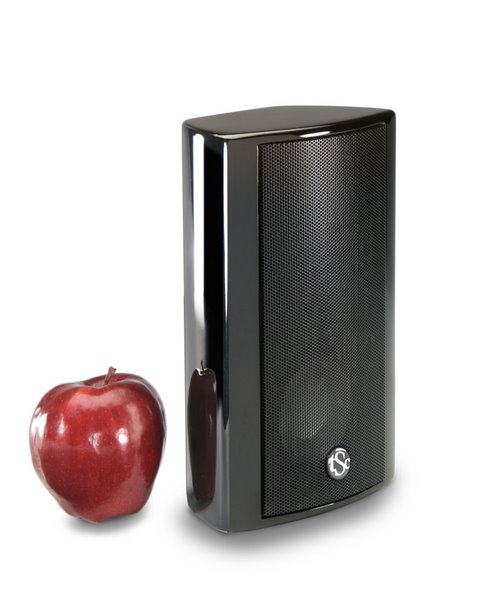

SAT1000-apple.jpgThere’s the famous saying that I usually follow “if something sounds to good to be true, it usually is.” It does me well to avoid scams and snake oil gimmicks. Last year an unknown online speaker company came on the scene known as “The Speaker Company”. When they approached us, I kinda brushed them off as a “White Van” speaker scam that wouldn’t last. Little did I know these guys were well connected and part of the D&M Holdings group that also owns Denon, Marantz, Snell, McIntosh and other high end A/V companies. I soon started seeing a lot of buzz about this company on our forums and when I went to revisit their website, I was floored by how much it has grown both in product selection and design execution. It was time to put aside my preconceptions and give them a whirl. I mean how critical could one be of a 5.1 system consisting of 5 two-way satellites and an 8” powered subwoofer selling for under $400, especially when the speakers are only about the size of two stacked apples?
Build Quality
The TSAT-1000

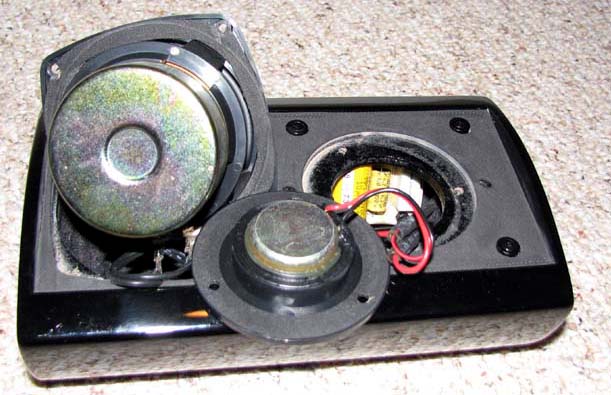

ASW8drivers.jpgFor this price, I was expecting cheap particle board cabinets and plastic grills. Instead I was rewarded with a lacquered black finish (TSAT-1000s) that rivals some speakers costing 10X the price. The cabinets were very inert and the speaker heavier than its diminutive size would suggest. What really floored me was the wonderfully contoured enclosures, flush mounted magnetized metal grills and beautiful gold spring-loaded speaker terminals that could accommodate my 10AWG speaker cable without any issues other than you must apply a good deal of force to push the terminal down to feed your speaker cable through. From an aesthetics standpoint, these speakers look like they each cost the entire systems asking price. I was even surprised to find they used a felt material on the front baffle to help reduce diffraction. All of the drivers were recessed into the baffle as well. The latter point is something many more notable speaker companies have still yet to figure out that this helps ensure good off axis performance and it should be standard practice in all of their product designs.

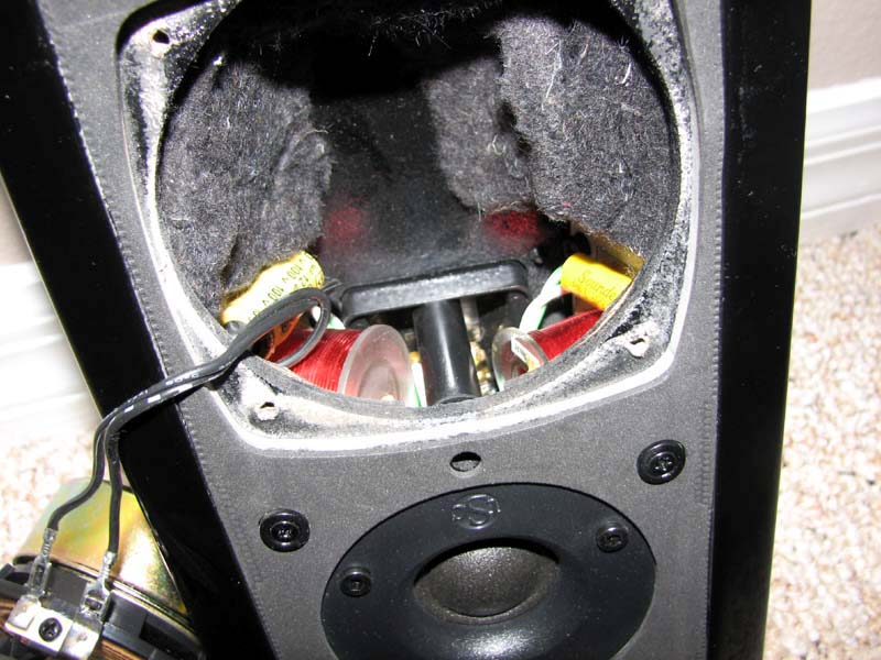

xover.jpgThe drivers of the TSAT-1000s utilize plastic baskets for the woofer which happens to be properly magnetically shielded with a bucking magnet and encapsulated can. The cone material is a doped aluminum with a butyl rubber surround. The tweeter utilizes a neodymium magnet structure with a poly-cell dome reminiscent of the pre-Harman Infinity speakers of the late 80s / early 90s. The crossover network was another big surprise to me. Instead of using a cheap 1st order high pass filter with an electrolytic cap in series with the tweeter like so many competitors do at much higher asking prices, tSc put a lot of thought and high quality parts into the crossover network of this system. This helps explain why the performance exceeded my expectations. Almost half the cabinet is stuffed with high quality air core inductors, high grade polypropylene audio capacitors and ceramic resistors. From what I could tell, the TSAT-1000s employ 2nd order high pass filters on the woofer and tweeter network. This cabinet is packed with quality parts and should make buyers feel good about purchasing a quality engineered product that just happens to be priced below the real market value.

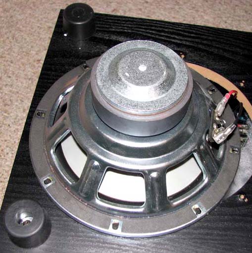

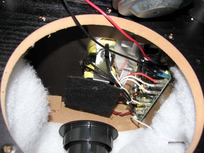

Getting inside the ASW-8, we see a nicely stuffed cabinet which appears to be molded from 5/8” thick MDF. The amplifier has a nice meaty power supply and the 8” driver with a 1” voice coil and 18oz magnet with a metallized stamped basket. The subwoofer is unshielded so keep that in mind if you plan on using this for a computer system. tSc claims the woofer uses a Santoprene surround featuring a ribbed shape to allow for a long travel without the woofer cone moving off center at either end of the stroke. The woofer cone seems to be a poly cone but has the appearance of an aluminum driver.
