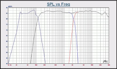

XdS Loudspeaker
2-way, acoustic suspension, Biamplified
1" aluminum dome tweeter, 5.25" magnesium cone MF/LF driver
2.1 kHz
108 dB/Octave, 108 dB/Octave,
110Hz - 30kHz, ± 1 dB

XdW Bass Module
Powered, dual-driver (10”), acoustic suspension
28Hz - 110Hz, ±1 dB
Built-in 500 W PowerPhysics Class D Power Amp
Two 10” Aluminum-cone drivers
110 Hz
48 dB Lowpass/ 48 dB Highpass, DSP implemented
