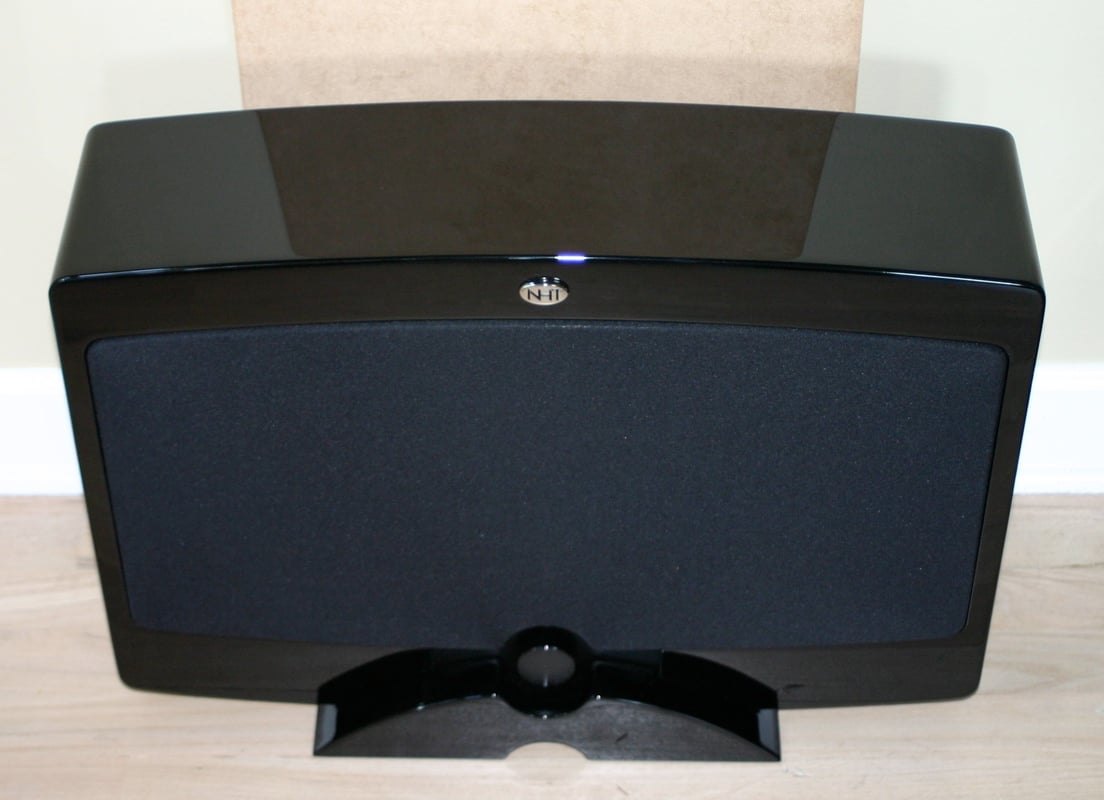

NHTsubThe first thing you will notice about the Verve system is the V-woofer, which is the included powered subwoofer.  For starters, it looks like a black flat panel TV.   It is vertically oriented, standing about 17" tall by 23" wide.  It is just over 7" deep.  Behind the black fabric grill you will find twin anodized aluminum 10" cones mounted side by side.  In the center at the base of the unit is a large black level control that looks like a huge volume knob from a high end amp or processor.  A small indicator lamp above this control is the only other item found on the black, high-gloss cabinet.

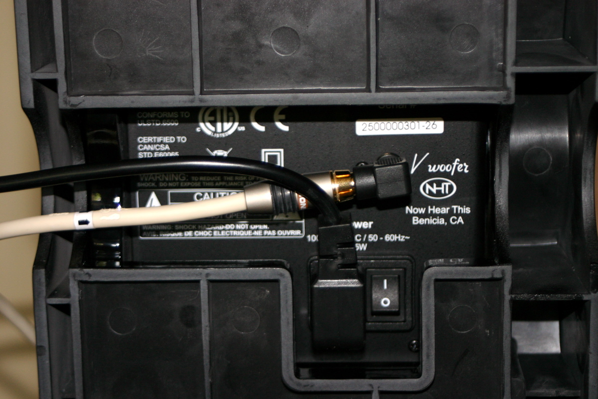

NHTundersubFlip the sub over to view it's underside and you will find a power cord connection and a single LFE audio input.  The included power cable is of the right-angled variety, and NHT includes a right angle RCA type adapter for your subwoofer cable.  I found this design to be a bit flawed, as it causes a 90 degree intersection of the two cables, which both need to be routed out of a wire tunnel to the rear of the sub.  I discussed this with Jack, and he acknowledged that this is a design item that could be improved.  I suggested that if the input jack was moved even an inch, it would not be an issue.  Jack was candid enough to thank me for the input, allowing that many times the engineers are not privy to "real world" feedback like this that helps to improve products.  In fairness, if you were to run your sub cable out of the wire tunnel on the front side of the sub, you would not have this issue.  But most people will want to hide the cables behind the sub, not have them coming out of the front, unless the sub is installed behind a table or other piece of furniture out of view.
Noticeably absent from the sub is a phase control and crossover adjustment.  Jack explained that this is by design.  Since most A/V receivers have a time delay adjustment, this in essence performs the same duties that a phase switch would on the sub itself.  Likewise, crossover duties are also handled by your A/V receiver's setup options, and there are no full-range line or speaker-level inputs that would require an adjustable crossover.  NHT wanted to keep the system and the V-woofer's controls as simple as possible.
The V-woofer is designed to be placed against a wall, or very near a wall.  The flat design allows you to do so with minimal effort, and it uses much less real-estate than a typical powered sub.

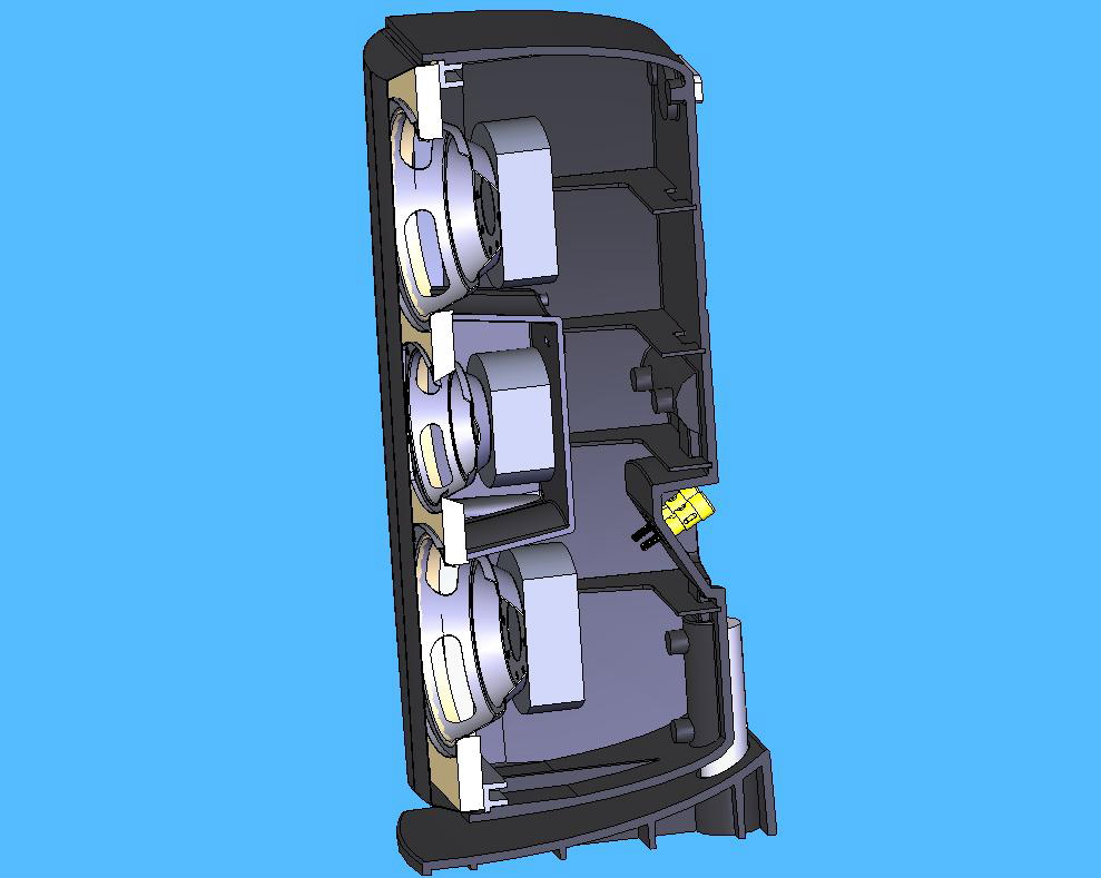

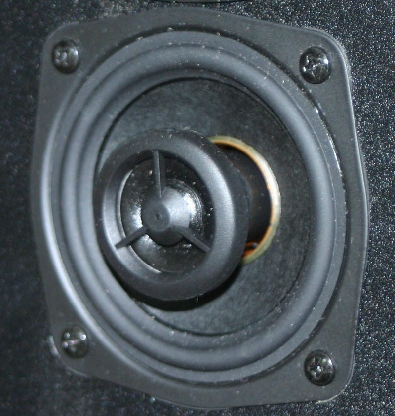

NHTdriverThe rest of the system is comprised of two V-small surround speakers and three V-large bookshelf speakers.  The V-smalls have 4.5" paper cone drivers and a coaxial combination midrange (3" paper cone) and tweeter (1" mylar) assembly.  The V-large speakers have two 4.5" drivers and the same combo mid/tweeter assembly.  The V-large stand 15.5" tall by 5.5" wide, and the V-small is 10.75" x 5.5".  Both are 6.25" deep.  The cabinets are magnetically shielded and have keyhole type mounts on the rear for wall mounting, and come with matching base stands that can be easily removed if you are not using the speakers on a shelf or TV stand.
The cabinets are compression molded from a bulk molding compound that consists of polyester resin with fiberglass and wood particles.  The result is a dense, stiff cabinet with reasonable damping.  This process and the materials used allow for a very thick (5-6mm) wall.  The speakers are quite stout, weighing 13 (large) and 9 (small) pounds.  They have removable black steel grills, though the instruction manual suggests you not remove them.

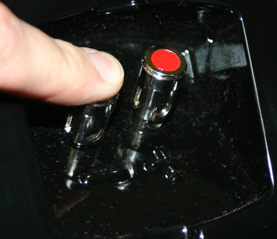

NHTpushOne advantage to speaking with an engineer of a product is that they get a chance to explain their rationale if you have a criticism.  Such was the case with the spring post-type speaker connectors.  At a glance, they look like traditional (albeit steel) binding posts.  I actually got out my pocket knife and began to pry what I thought was the red plastic nub in the banana plug hole on the positive pole.  I soon discovered that it was a red sticker, and that these were not 5-way binding posts, but push-pin type connectors!  So I asked Jack why, on a $2,000 set of speakers, would you use this type of connector?  He explained that much of the target market for this product does not know what binding posts are.  Furthermore, NHT expects wall mounting will be the typical installation for these, so banana plugs are not practical anyway.  He went on to explain that it was certainly not a cost-savings move, as the quality of the strong spring and size of the inner post is superior (and just as expensive as 5-way posts).  And truth be told, it is. These are the most killer spring post connectors I have ever seen.
