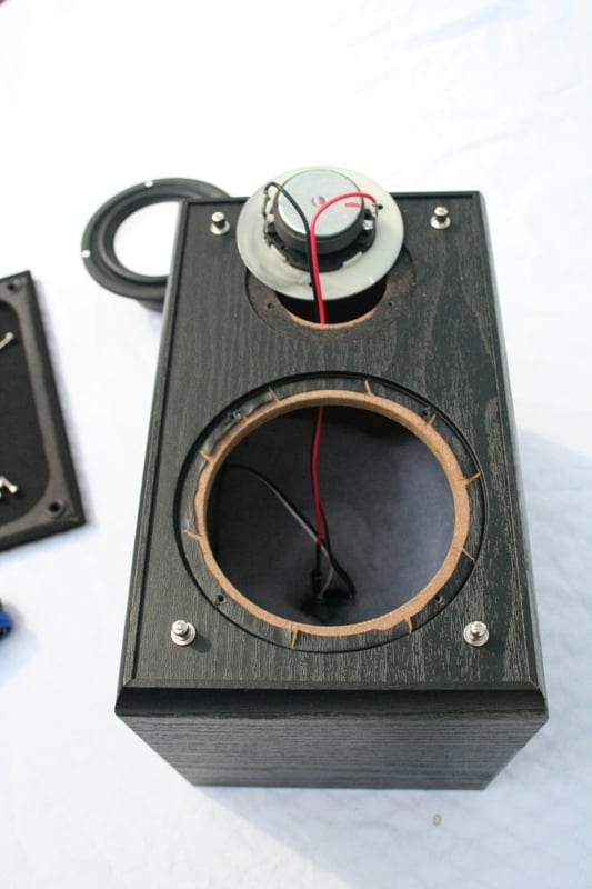

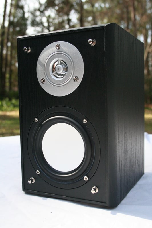

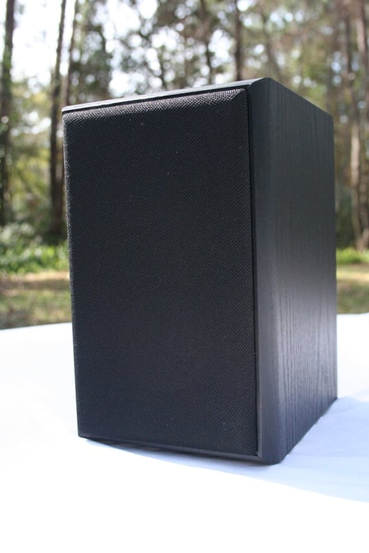

MCM_dis_cab.JPGThe 50-908's are constructed out of 3/8" MDF with a very thin piece of polyfil inside. The edges are glued and the exterior is covered in a black woodgrain vinyl wrap. The grills fit tightly on the chrome posts. The 50-9085 bookshelf speakers come with a metal keystone wall mount or sticky rubber feet that can be affixed to the bottom. The 50-9080 center channel only has the sticky rubber feet without the keyhole wall mounts.

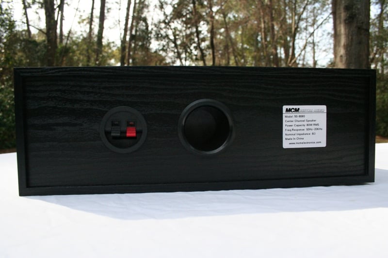

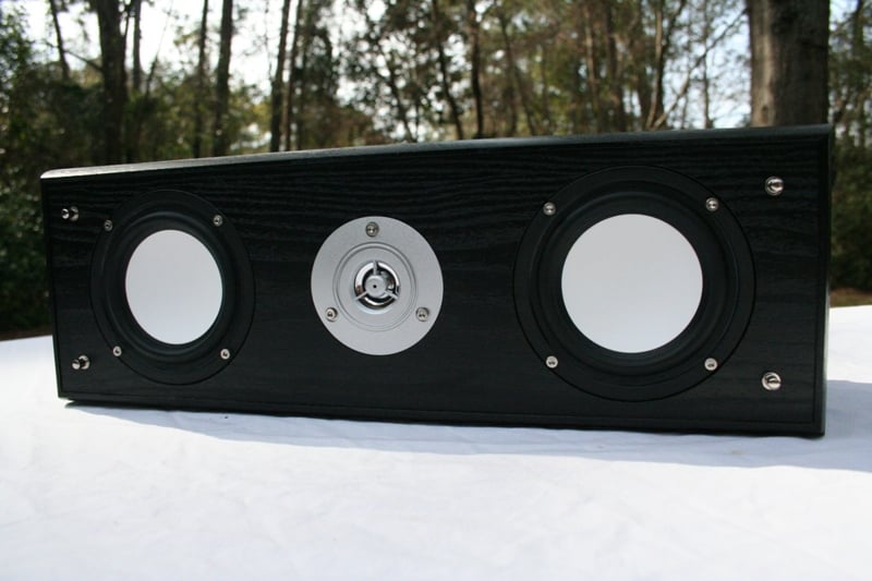

The speakers are quite small, though not as tiny as some of the cube systems out there. The bookshelves are sealed (regardless of what it says on the MCM website) which should make placement a bit easier (especially useful for neophytes that don't understand why the initiated insist that you shouldn't put bookshelf speakers in a bookshelf). The center channel has shielded drivers which are actually pretty useful at this price point. Usually, I mock shielded drivers as frivolous but mostly that is because anyone spending many hundreds to thousands of dollars on a speaker certainly isn't putting them on top of a CRT. The MCM speakers are at a price point where this could certainly be the case. I took the speakers into my office and held them up to the ancient CRT monitor that I should have replaced years ago. The smaller bookshelf speakers caused visible distortion but the center did not - verifying MCM's claim.

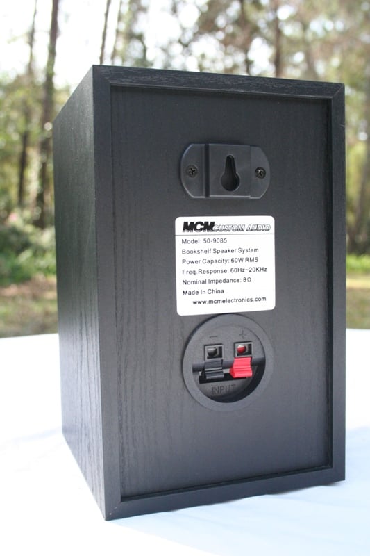

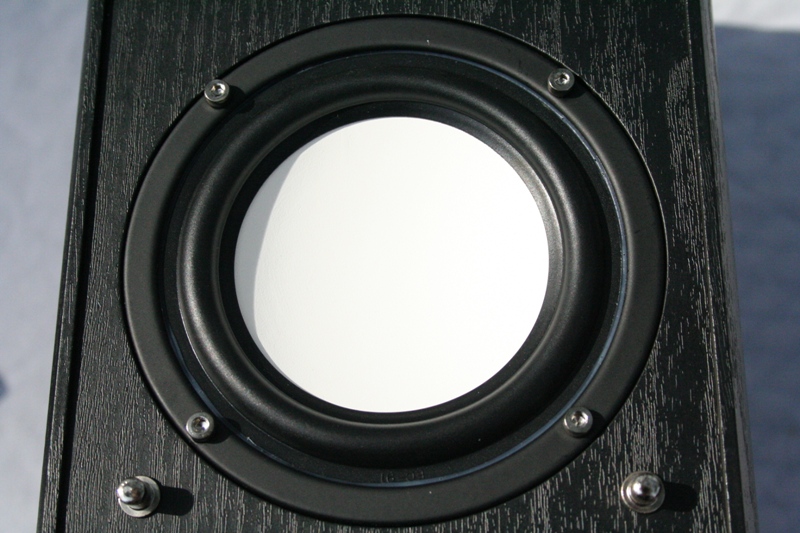

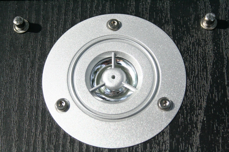

MCM_back.JPGThe back of the speakers sport plastic spring clips which really only accept bare wire. You will probably be limited to 16 AWG wire though with a little persuasion and perhaps some trimming 12 AWG might work. The tweeter is mylar and the woofers are poly cones that are painted to look aluminum. The overall look of the speakers is nice especially when you consider the price. MDF is a huge step over the tiny plastic enclosures that you might see in a competitor. The drivers take up most of the real estate on the front baffle of the bookshelves and the center is wide and short which will hopefully make placement in a number of different type of cabinets easier.
