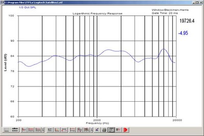

The satellites are workhorse speakers. You can crank this system up and the Z-5500 speakers will handle whatever you feed them without overt audible distortion. The only time I coudl see doing this, however, is if you intend to use these speakers in a room that is larger or in a configuration that departs form the recommended near-field positioning. I found them to be well-blended with the sub. A quick in-room sweep with the satellites close-mic'd using the Rives Audio Pro Test Kit yielded the following results:
logitechZ5500frequencyresponse
I ran the test from 200Hz up to get an idea of how the satellites were performing within the full frequency range apart from the subwoofer interacting with the system. A separate sweep from 20Hz to 500 allowed me to see the subwoofer performance, though at lower frequencies you are likely showing off room interaction as much as the subwoofer's frequency response. The Logitech Z-5500 full range 3" satellites sounded pretty close to this graph - a bit lacking in mid-bass and a tad peaked in the 2 kHz to 3 kHz region. It is this peak that contributes to fatigue when listening at high volume levels (though I realize everyone is terribly impressed with the ability these speakers have to reach high SPLs.) In my opinion, these speakers sounded their best when the volume levels were around 75dB and the main speakers were toed in only slightly (not completely facing the listener as recommended in the setup manual.) This preserved the soundstage while rolling off some of the crispness I experienced when toeing them completely in. This is entirely subjective and we encourage you to experiment to discover your own preference.
