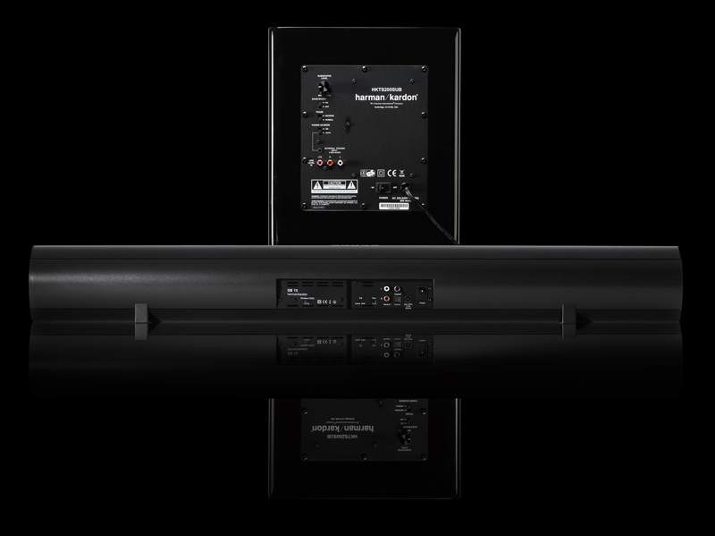

SB16_back
As you can see, there are three inputs on the back of the SB 16 bar - analogue, coaxial, and optical. This allows you to connect multiple devices which is important. Those looking for a surround bar are generally not interested in using a receiver. If you assume that they are only using one source in a room, you can get away with one input (an unreasonable assumption in our opinion) but we highly recommend as many as possible. What you will also notice is the complete lack of input on the subwoofer.
Instead, what you find on both is a Wireless Code switch. This gives you four different channels in case the wireless connection between the sub and the bar is meeting interference. In this day and age, if you are putting out a surround bar solution, it is almost mandatory that there be a wireless option for the sub. At the $599 price point of the Harman Kardon SB 16, it's a pretty good deal.
