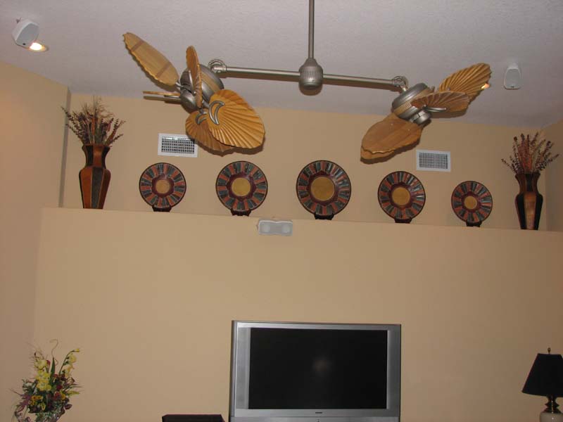

The review system was installed at my neighbor's house who is quite a music enthusiast but has strict WAF requirements to have no visible boxes messing with the room décor of their living room. It was actually his idea to ceiling mount all speakers but the center channel. I convinced him to mount the ECA-44 center channel on the wall just above his flat panel display using two EMP speaker brackets for better integration with his display.

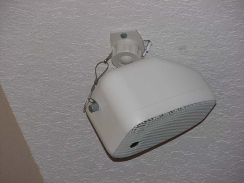

ceilingeca-4.jpgInstallation was a breeze using the EMP EMB speaker brackets which are sold separately in pairs for roughly $80. The mounting brackets are made of quality constructed rigid plastic and come with all of the necessary hardware for installation. The two piece ball and collar bracket system allows you to disengage the bracket in order to install the mounting portion (collar) to any wall or ceiling simply by screwing into the stud. The remaining ball portion is than attached to the back of the speaker and snapped into place in the mounted collar portion. The swivel design allows the speaker to be directed to the optimum listening position and a safety wire completes the installation and ensures if the speaker somehow dislodges from the mount, it won’t come crashing down. While I felt these were quality brackets, $80 is steep and makes a big difference in the overall price of the system. If these are the speakers you're interested in, you'll want to keep this cost in mind as aftermarket brackets likely won't work with these speakers.

Editorial Note: Placement Guidelinesfans.jpg
When installing these speakers, I suggest you take mental note of coverage area and the best way to achieve a direct path of sound to that area. Placing speakers too high will reduce the fidelity and weaken the high frequency reproduction as you will be listening to the speaker too far off axis. Thus if you must place the speakers in such a position, it is highly recommended that you swivel them down towards the listening area ensuring the tweeter is firing directly at the seats. Try to place the front speakers further apart than just the width of the display (if your significant other will allow it). In order to get the biggest possible soundstage and best imaging, they should be about 80-90% apart as the distance between their central plane and the listening area (IE. if you are sitting 10ft from the display, the speakers should be about 8-9 feet apart). The closer you can get the center channel to the display the better to give the illusion that the voices are coming directly from the picture. This is why I convinced my friend NOT to ceiling mount his center channel.
