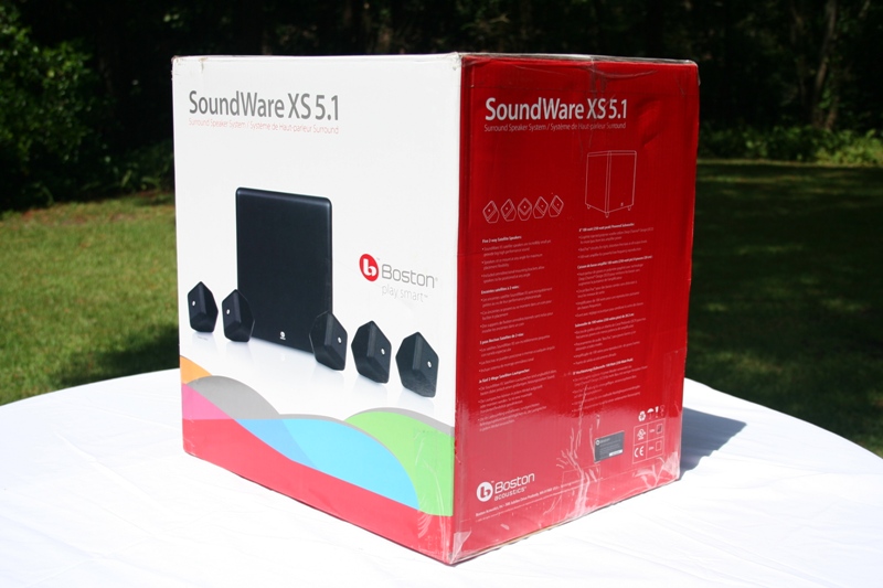

As you might expect, the SoundWare XS 5.1 system came packed in a single box with plenty of protection. The speakers had their own individual layer with little cutouts for each one. The sub, while small, was again well protected toward the bottom of the box. Each speaker was covered with foam tissue paper to protect the finishes.

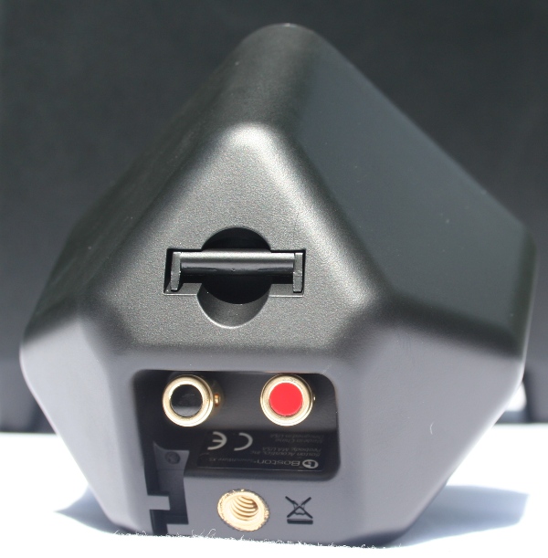

SoundWareXS_togetherThe speakers may be small but they have a very interesting design. While they look like cubes, they are engineered to be very versatile. The speaker can be set on any side which has a variety angles. You can use these angles to aim the speaker when it is sitting on a shelf. Since the 1/2" dome tweeter is mounted coaxially with the 2.5" woofer, you just have to make sure the speaker is pointed in the right direction and not worry about which way is up. On top of that, Boston Acoustics has included not just a single mounting option, but two (many competitor systems require you to purchase mounts separately). The first thing you'll do is install a pivoting ball mount to the back of the speaker. Then you mate that to either a nearly flush keyhole mount for wall/ceiling applications or a straddle mount for corners. This gives you a huge range of mounting options and much more than you'd expect at this price point. The speakers all mount very close to the wall so it presents a very clean look (though you're still going to see the wires poking out from behind).

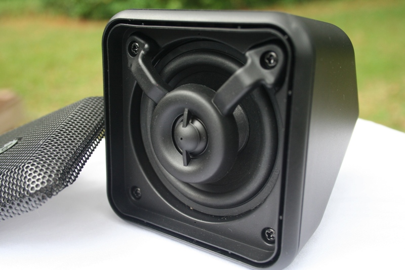

The cubes feel sturdy for their size (just about a 3.5" cube) with a plastic housing and a metal grilel. They weigh in at only a pound each. The grille doesn't generally come off unless you have children that trip over the speaker cable and dump them on the ground. The 'little speaker that could' didn't break (landed on carpet off a Chest of Drawers) but it did give me the opportunity to take a picture of the drivers. I didn't dare take the speaker apart for fear of never getting it back together again. Each of the cubes are magnetically shielded so you can place them on top of your CRT.

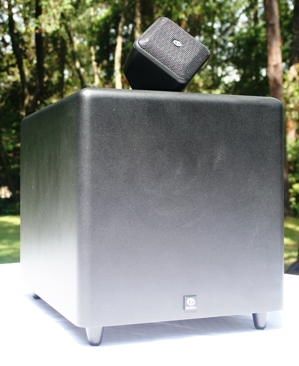

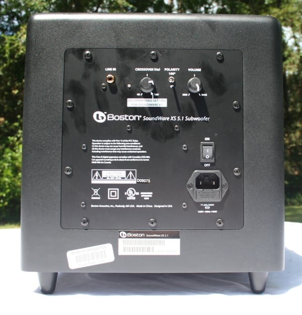

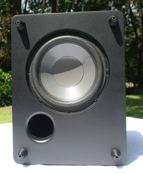

The sub is very small at about 12" tall and wide and a bit more than that in depth. The bottom sports conical plastic feet that should be fine on carpet but rubber tips would have been preferred for hardwood. There is a downfiring 8" driver and a downfiring port (near the front). The back of the sub sports a 100 watt plate amp with RCA line in, variable crossover and volume knobs, and a phase switch. The crossover ranges from 60 Hz (yeah, right) to 180Hz. I was surprised to see a removable power cord which will help users with longer power cord runs. The sub is light but solid, though the knock test is predictably resonant. You can't really fault a sub at this price point for too much as long as it plays. At only 20 pounds, you won't have much trouble moving it around. The finish is textured, rounded, and feels very robust. The matte color choice should be more resistant to dust as well.
