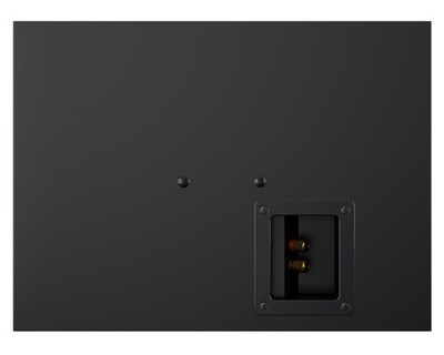

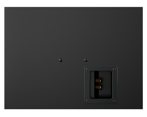

Verus-surround_back
The back of the speaker is fairly spartan with a single set of five-way binding posts and two rubber nubs that cover threaded inserts for use with the included wall bracket. The speaker is a relatively heavy 13 pounds and is 9.5" tall by 13" wide by 7" deep. Like the rest of the Verus line, the Verus Surround eschews the industry standard MDF for the more rigid (and expensive) HDF for the enclosure material. The speaker comes in either a high gloss black or high gloss cherry furniture-grade veneer with acoustically transparent, magnetic grilles. A 10 year warranty, free shipping, and lifetime technical support are included as they are with all Aperion offerings.
