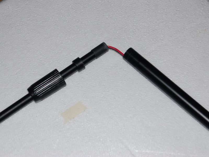

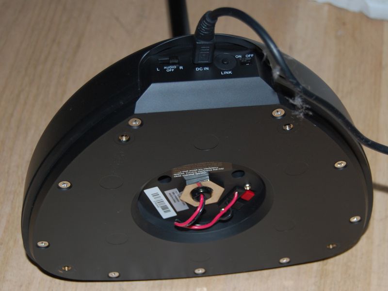

The WHT24 contains a transmitter, and two receivers that are built into the base of each of the included wireless speaker stands.  The packaging resembled an oversized pizza box, and assembling the two stands reminded me of the college days when I was putting together the halogen torch lamps that were essential to 80's single-guy decor.  You have the base, a threaded bottom pole and a smaller upper pole, with speaker wire running through the interior.  And sadly, it was just as frustrating putting these together as I remember with the lamps.  The first one went together just fine, but the second one had issues.  The top and bottom poles are connected via an inner plastic grommet and an outer locking sleeve nut.  The sleeve is plastic, and just did not want to lock down.  The thread was probably stripped, or at least became stripped as I tried over and over to get the alignment right so I could tighten it down.  This is an issue, because it determines the height of the speaker that will be installed on it.  I was finally able to get it tight enough to work, but any adjustment for height was going to be tough due to the weight ofAR stand the speaker. I talked to AR about the design, and they were very interested in the feedback.  They explained that there were several challenges in creating such an elegant, slender design for the rear stands, while still controlling costs and functionality. They also felt that most consumers will not be constantly adjusting the height of the stands. This is a good point, because with the design as it is, after repeated use or adjustment the sleeve is going to wear out and this will be a problem for the owner.
Once I had assembled the stands and attached the speaker cable (which is pre-threaded through the poles) to the standard push-pin type connectors on the underside of the base, all that was left was to plug them in.  Each base comes with an AC brick/power adapter.  This is important to keep in mind with a "wireless" system such as the WHT6024.  It is wireless only in that you do not need to run speaker wire from your amp or receiver. You still must have AC outlets nearby to plug each base into. Still, finding an AC outlet is much easier than running surround cables for most folks.AR transmitter

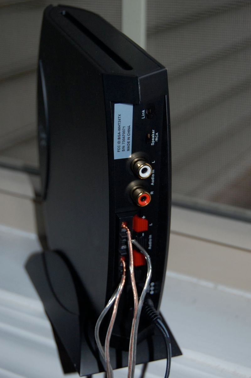

The transmitter is simple, and at first glance looks like an old Motorola Surfboard cable modem or a Vonage router box.  There is a stand included that allows you to mount it vertically, just as you might with your modem.  On the rear are push-pin type speaker connectors that allow you to run speaker wire from your AV receiver to the transmitter.   There are also left/right line level audio inputs for use with rear surround pre-outs if you prefer (you can use either method but not both at the same time).  A power switch, RCA/Speaker selector, "Link" switch and power supply input round out the rear panel.  A green LED on the front of the transmitter lets you know it is powered up.

One thing I noticed about the surrounds was that when I had my system turned off, there was a slight hiss emanating from the wireless speakers. I did not notice this when I was using them, but when the room was quiet and the system was turned off, it was very noticeable.  And it is not convenient to power the wireless receivers in the base stands down each time you turn your system off. But there is a way to get around this.  The amplifiers in the base stands are designed to be operating at full output all the time in order to accomplish their job of providing full range sound to the surround speakers.  If they are not receiving a signal from the transmitter, they will mute and go to sleep.  So the solution is to plug the transmitter into a switched outlet (possibly in your rack or the back of your AV receiver) so when you are not using the speakers it will be turned off.
