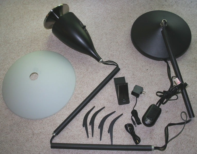

duo_apart.JPGAt some point in every college student's career (usually many times over the course of a life) they've bought a floor lamp. It seems to usually live behind a couch or next to a reading chair. If you've ever put together one of those lamps, you'll recognize a few similarities (and some major differences) with the Soundolier offerings. First the similarities: The box will be impossibly small (so much so that you'll wonder how they got all that in there) compared to the size of the lamp that comes out. The assembly is quick and easy with the "stem" of the lamb broken down into three pieces that screw together, to the base, and to the head. The wires are pre-threaded through the stem and all you'll need to do is pull them taut from the base and hide the excess underneath. The frosted glass mounts to the top by a plastic ring that sheaths the bulb (don't over tighten or you'll break the glass). There is an on/off and dimmer switch on a foot control. The entire assembly should take you a couple of minutes at most.

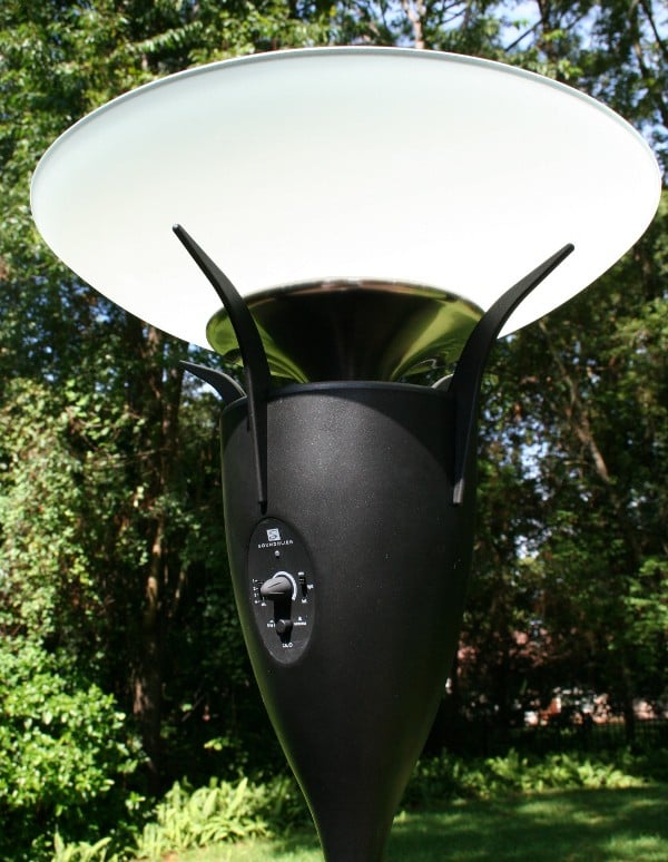

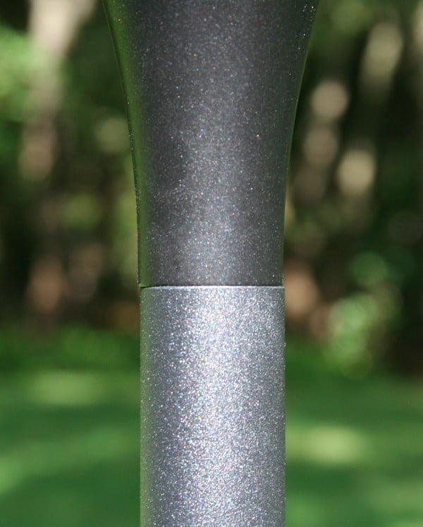

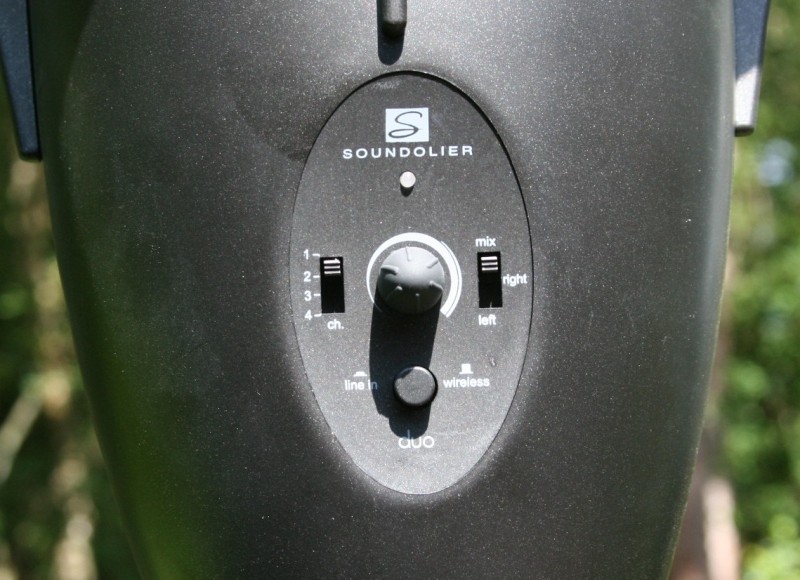

duo_mismatch.JPGNow the differences: This lamp is HEAVY! How heavy? At 37lbs it seems a lot heavier than it should be until you learn that the base in filled with concrete. The lamp stem still wobbles though, with the heavy base, there is more of a chance of breakage than tipping. The power button on the foot control doesn't turn on and off the light but the speaker while the dimmer is solely for the light. There is a control panel on the head of the light with a volume control, a button to select a wired or wireless connection, a switch to select one of four channels, and a second switch to choose left channel, right channel, or mix playback. The LED light glows green when there is an incoming signal, red when there isn't, and isn't illuminated when the power is off. As long as the LED was faced away from my seated position, it was never noticeable or distracting. The plastic housing of the head was a slightly different color than the metal stem but this was only noticeable from up close. Just below the brushed metal funnel (for lack of a better word) is the up firing 5.25 inch speaker. This gives the duo a 360 degree sound dispersion. On the base, straddling the power cord, are 3.5mm input and output jacks. The decorative fins (Soundolier calls them "cosmetic arms") between the speaker and the glass can be removed if you like though I thought they looked pretty good.

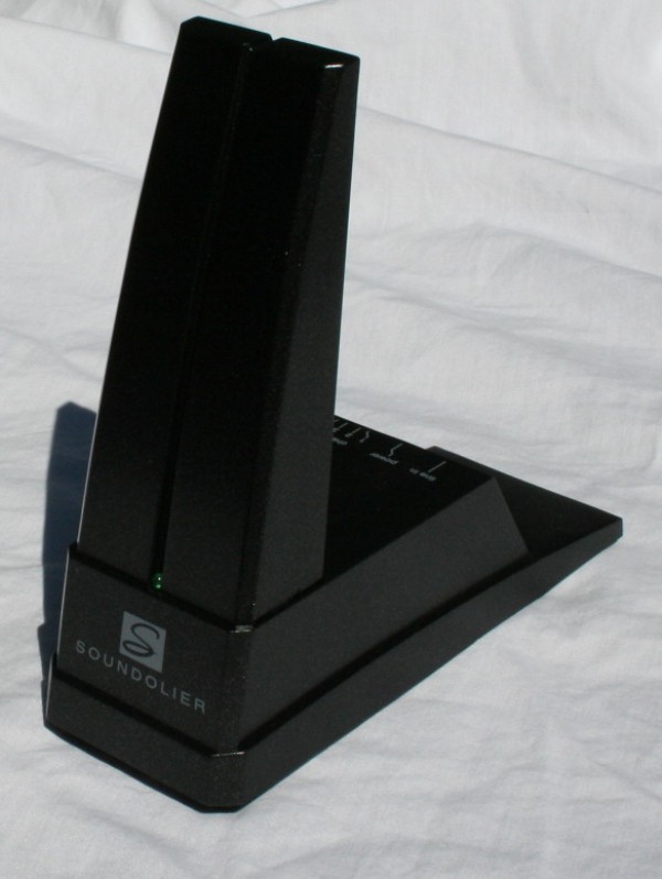

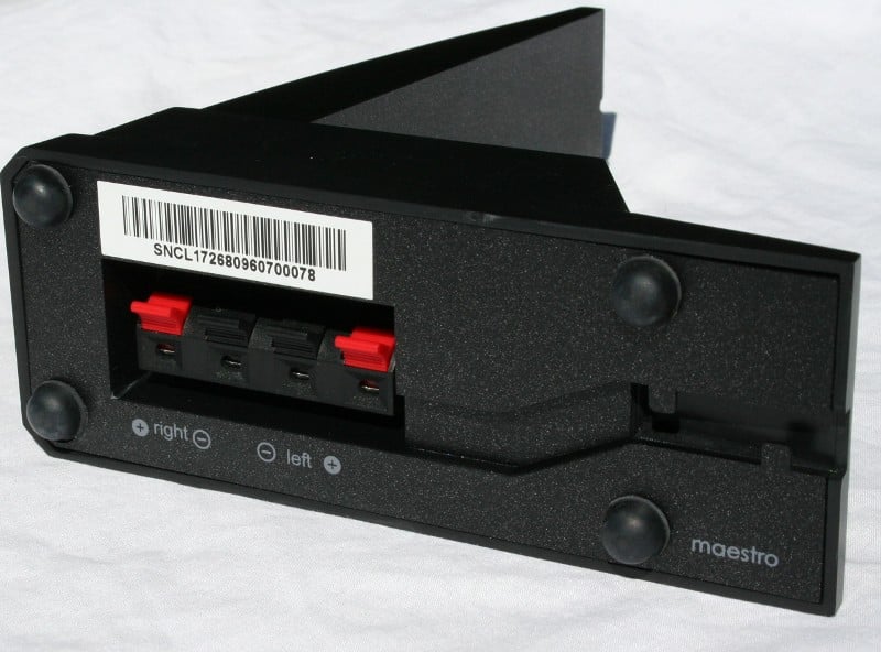

duo_maestro_front.JPGThe maestro wireless digital audio transmitter is fairly nondescript except for the small LED on the front which glows green to indicate power. The dark color seems to blend in to almost any background and with the right décor it might even make a nice accent piece. On the back of the unit there is a 3.5mm input jack, a four channel selection switch, and the bottom of the unit has high level speaker inputs with a very thin trough to snake wires through (no 12 gauge allowed). The maestro and duo operate on a 2.4 GHz frequency range which may interfere with some of your other electronics (cordless phones and wireless routers come to mind) but the number of channels will help guarantee that you can find a channel that won't cause a problem. I found channel 1 was completely unusable in my home because of interference with my portable phone though the other 3 were no problem.

duo_control.JPGThe maestro sends out a full range signal (supposedly, I can't test that) with information from both left and right channels. You select if you want the lamp to reproduce the left, right, or a mix of both channels. You can connect the maestro to your receiver using bare wire or to a computer or MP3 player (basically anything with a headphone jack) from the 3.5mm jack. As mentioned, if you go the bare wire route you'll need to use fairly small wire else the unit will not sit properly. Thinner wire shouldn't be much of a problem as your wire runs should be ridiculously short.

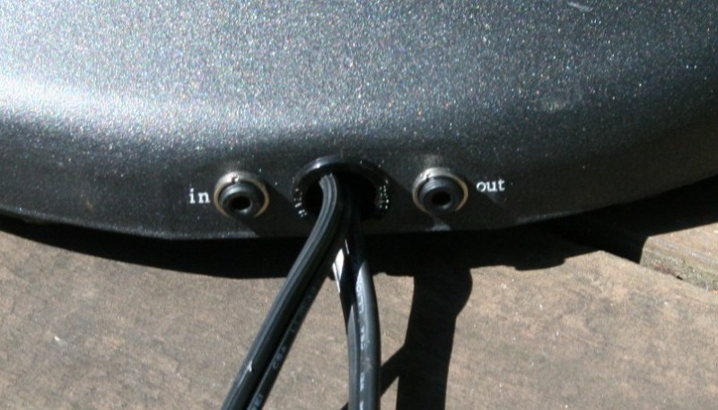

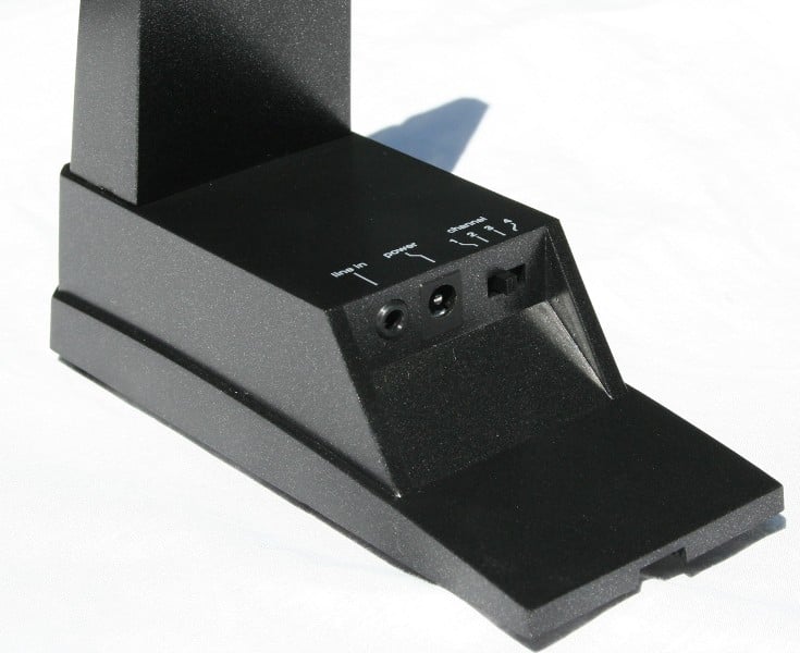

duo_base.JPGEach duo has an output on it that can be used to either hardwire a number of the lamps together or to send the audio to a maestro for additional distribution. For example, if you had a large store and want music distributed throughout but a single maestro isn't getting a clear enough signal to the other side, you can connect a maestro to a lamp that is getting a clear signal and set it to a different channel. You can then set the lamps on the other half of the store to the second channel and have the same music playing everywhere you'd like it.

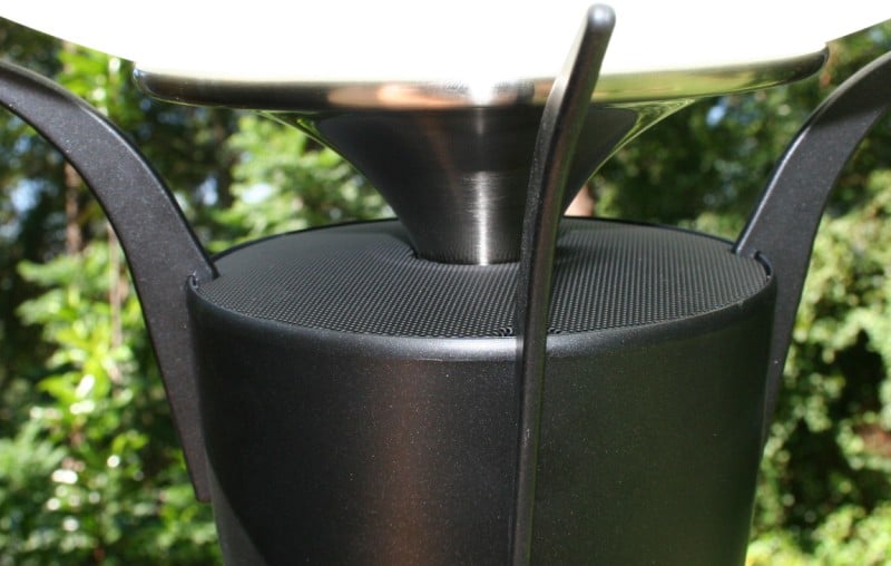

duo_top.JPGTo this end, I spent a lot of time listening to different music including Marillion's Mables. The duo's presented a spacious effect if fairly light on bass (I popped in the Rives Test CD 2 and got some output at 80Hz but really useable output somewhere between 100-125Hz). The music was, however, enjoyable and filled my room nicely. I can see how these speakers would work well in a doctor's office, furniture store or in a large living space. I was surprised at how well the full range drivers handled the top end. Cymbals and high guitar notes rang true to my ears. What I especially appreciated was how well-distributed the sound was. While I could sit under the lamp and hold a conversation, across the room the music was still loud enough to be enjoyable. This bodes well for owners looking to fill up a large room. In all honesty, I'd like a pair for my family room. They'd be perfect for casual listening during a party or even just while hanging out with the family. The setup is a breeze and with proper placement and setup, the maestro won't harass any of your other wireless devices.

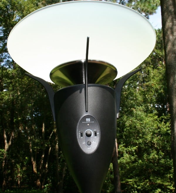

duo_light2.JPGOverall, I really liked the maestro/duo combo. Soundolier has obviously worked very hard to ensure a stable and strong wireless connection. I'm hoping to see that technology in a stand alone format in the near future. I would have no problem recommending these speakers to anyone that has décor issues (as long as you don't turn them up too loud) or is just looking for a nondescript way to get background music into a room without the hassles of wires. They are an expensive solution for sure but the ease of setup and the rock solid wireless connection may make that extra money seem well spent.
