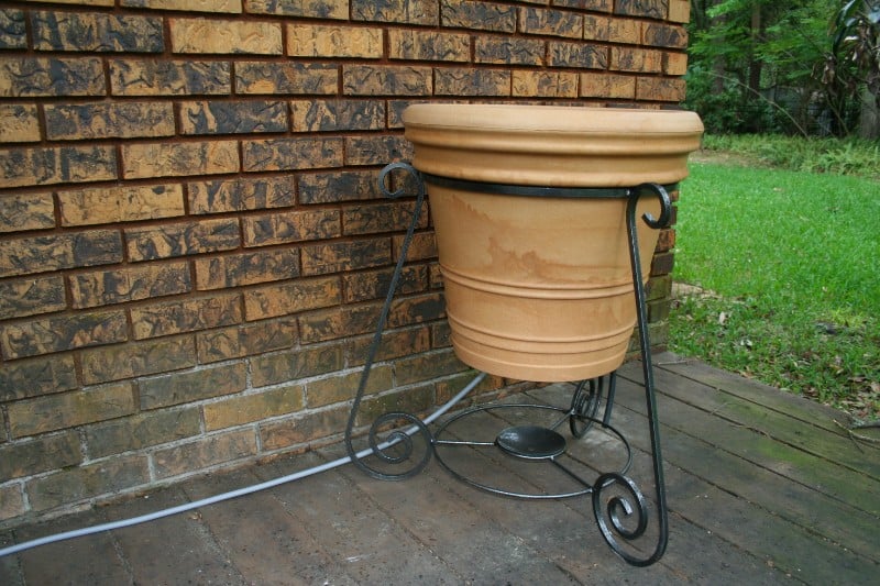

PlanterSpeakers_onwall.JPGI cannot stress enough that the Terra Cotta 8.20 doesn’t just look like a planter, it is a planter. That means you can plant an actual plant in there. A real live one. Not some fake plastic thing, but a real live plant. Soil, water, everything. It works just like any other planter you’d buy at the store (except you have to run speaker wire to it and it makes noise). This is a feature that I’m afraid too many people are going to overlook. It is one thing to buy a speaker that looks like rock. It is another to buy a speaker that is a rock. While rocks have limited uses, planters do not. My parents are really into plants (thanks HGTV for sucking up my meager inheritance though Japanese Maples) and I don’t think I’ve been to their house twice and seen the same plant in a planter. They are constantly switching them out. If you told my mom that she could have two extra planters out there instead of outdoor speakers, she’d jump at it.
