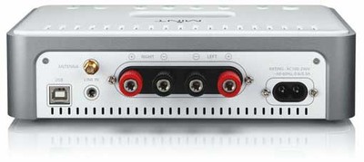

Setting up the system was easy, and I found that you can use the Mint in a number of ways. After studying the parts (User Manuals are for sissies… but they do make for good bathroom reading after you make an initial go at it) I was ready to begin. Unboxing the unit (which comes well-packed and protected with custom foam packaging and a nice box for the iPod dock and accessories) I laid everything out. There are two speakers, the main amplifier unit, a remote iPod dock, credit-card style remote control, antenna and assorted cables. It's not a tough system to assemble and everything connects the way you'd expect.

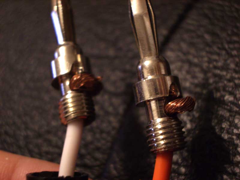

The speakers connect to
the main unit via supplied Canare cables. These cables are 16-gauge and have a
unique termination method. Apparently the cable ends go through a hole, wrap
half-way around the connector and are hidden under the screwed-on plastic
strain relief. There is no soldering and strain relief is limited to the
plastic banana jack covers. Now I'm not one to spend any time on cables, but
these seemed like they could lose connection at any time or at the very least
pull out over time if you don't handle them correctly. To be safe, be sure to
grab them from the red and black covers and not by pulling on the cables
themselves.

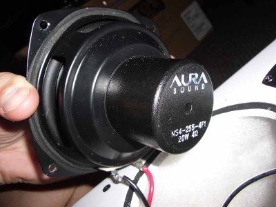

The woofers are basically NS4-255-4D drivers from Aurasound and feature a 4" high-output woofer with a neodymium ring magnet that has an unusual shape to it that contributes to its excursion ability (nearly 1" peak to peak, though I never gave it enough juice to make it throw that far). The driver was wired to the crossover via two 12-gauge soldered cables and was flush-mounted to the enclosure.

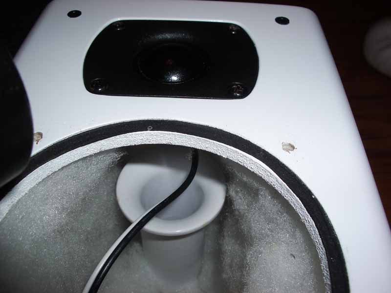

The enclosure itself is made up of 1/2-inch wood with a thick piano-gloss coating that gives each speaker a nice white sheen. The corners are rounded and build quality is impeccable for this price. The inside of the cabinet was well-damped (over-damped?) with polyester fill - and with a ported speaker this small I wonder if it actually might have changed the tuning frequency of the box.

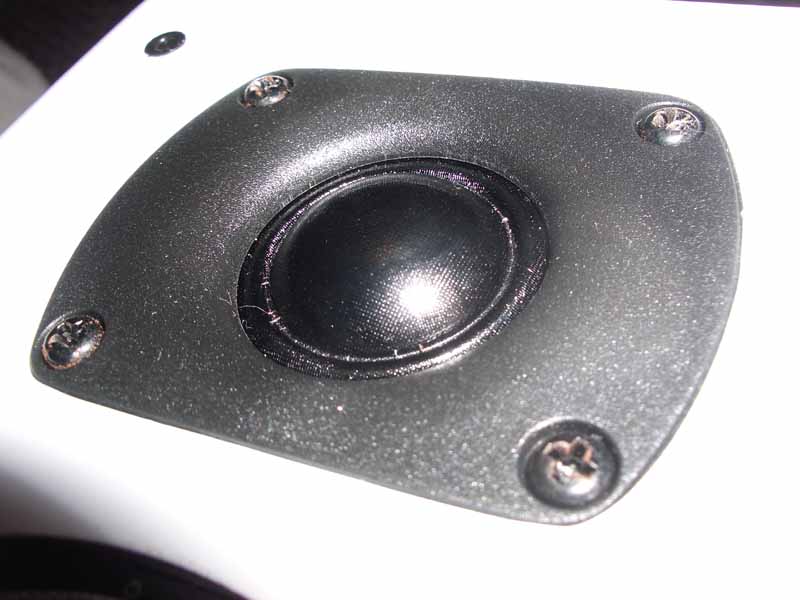

The tweeter is essentially a BC25SC55-04 which is
meant to be recess-mounted. On the back I noticed a heat sink which, in
combination with the ferrofluid in the magnet gap, helps cool the driver and
aid in handling more power output. This is a decent driver with an effective
frequency response up to 25 kHz - and we all like to play tricks with the
neighborhood dogs every now and then, don't we? The tweeter was mounted almost
on top of the flared port which extended about 75% into the cabinet. At the

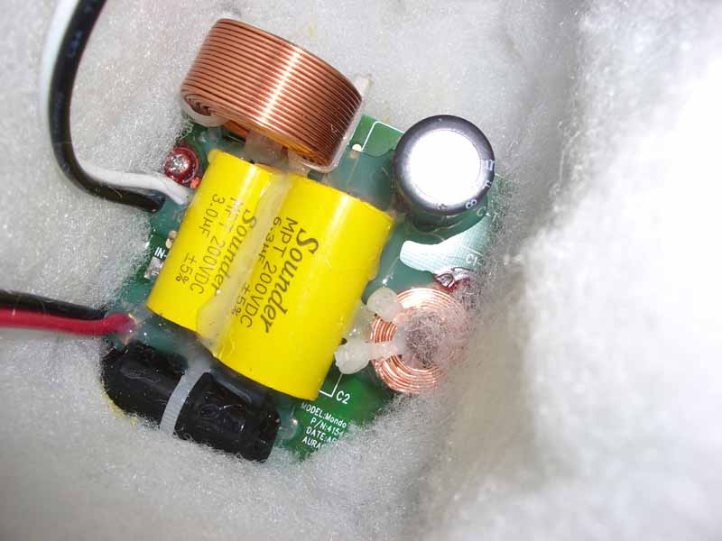

bottom was the crossover, which featured air coil inductors and polypro bypass
capacitors in parallel with a series electrolytic cap to reduce equivalent
series resistance (ESR) in what appeared
to be a 2nd order LP and HP (12dB/octave) configuration.
