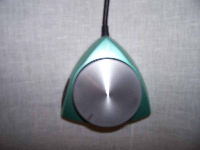

edifier-E3350-volume.jpgVolume is adjusted by a wired remote which features a metal dial with one little notch to indicate volume. When the system is powered on, a red light illuminates around the edge. The smooth metallic knob, unfortunately, smudges very easily. On the top of the dial are little circular grooves, so dusting only helps marginally. On the base of the remote and all speakers is a felt-like non-slip pad, which appeared to work well on all surfaces we tried. The remote also contains a headphone out and auxiliary input.

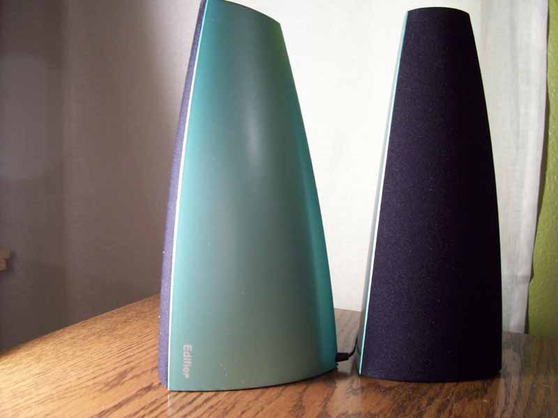

edifier-E3350-speakers.jpgThe two satellite speakers are average speakers with decent mid and high ranges. The two-way satellites, each with a 2.75-inch oval-shaped driver and 0.75-inch soft silk tweeter dome, are magnetically shielded. (This hardly matters in today's electronic market, unless you are using an old CRT monitor.) Looking at the speakers straight on, there is really nothing visually unique. However, if looking from the sides or from above, the speakers have a crisp shiny finish and look very nice.
