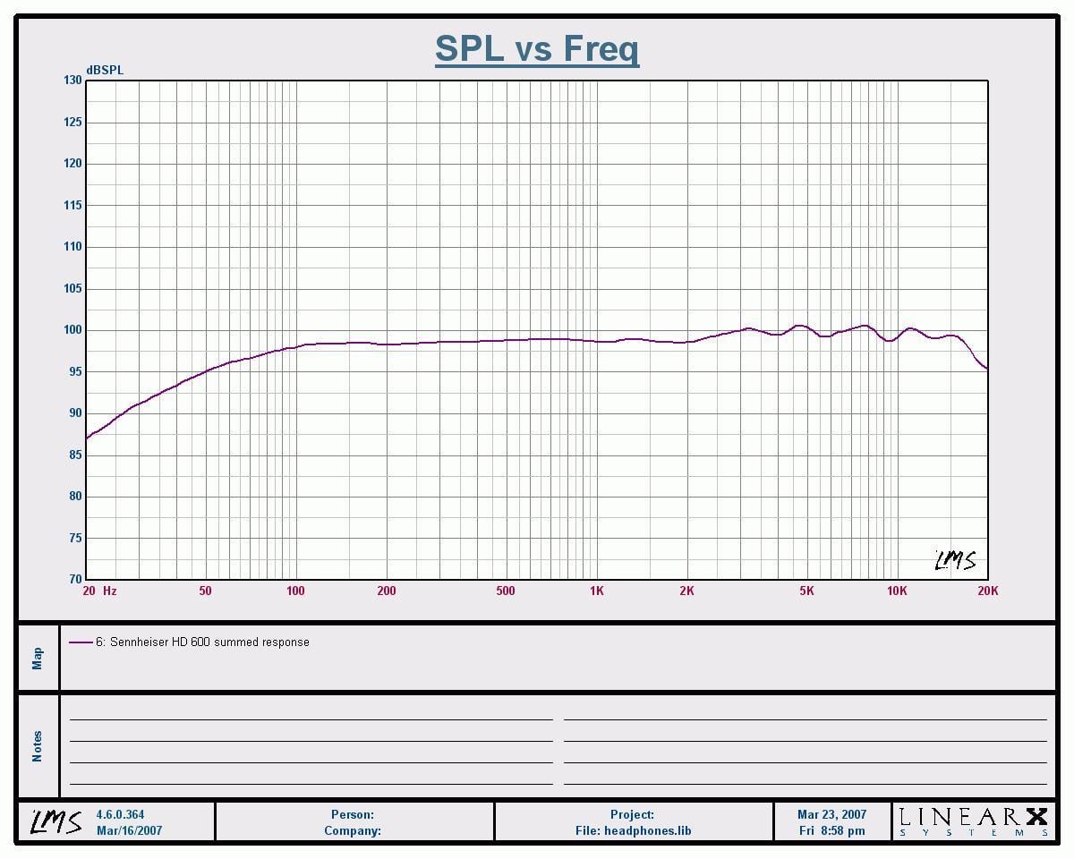

I quickly learned the hard way that measuring open air headphones is a bit tricky.  Unlike measuring an inner ear headphone whose cone area is approximately the size of the measuring microphone, or measuring say a subwoofer whose driver is infinitely bigger than the measuring mic, the driver of this type of headphone design is too small to be considered infinite size and too large to be treated as the inner ear headphone whose entire radiation pattern is directly captured by the microphone.  Thus I had to construct a crude approximation of a human ear using a Styrofoam cup punctured in the middle to squeeze my microphone through for frequencies below 200Hz.
sennheiserHD600freq
Summed Nearfield Frequency Response measurement of the Sennheiser HD 600
As you can see from the graph, these headphones are extremely linear.  I verified their linearity was equally excellent at various listening levels.  I don’t believe the enclosure I created is sufficiently accurate at the lower frequencies which explains the excessive roll off which did not correlate with my listening experience or the manufacturers published specifications.
