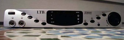

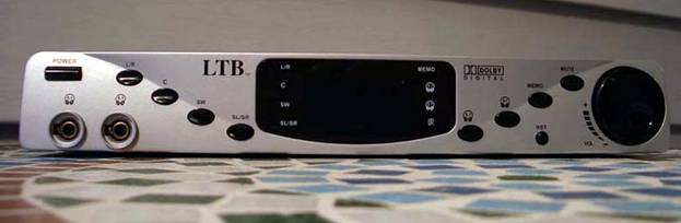

The headphone preamp is intuitive enough to not require thumbing through the manual to figuring out its most basic control settings. You can adjust levels via the front panel buttons on the preamp unit or via the nifty remote control supplied with this system. Unfortunately channel trims are only adjusted in pairs (ie. L/R Front, L/R Surround, Center, Sub). While we're sticklers about this in processors, this shouldn't be too much of an issue considering each ear is equidistant from the speakers in the headphone and there are minimal acoustical differences on either side, assuming you have normal hearing. Huh, what did you say?

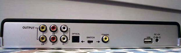

Surprisingly, the LTB AC3Amp5.1 sports 5.1 channel analogue outputs (a feature most sub $400 A/V receivers lack) for people wanting to use this as a preamp to power external amplified speakers or dedicated external power amplifiers. It also provides for selectable toslink or COAX digital S/PDIF inputs and USB connectivity to a PC.
