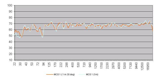

The MCS 1 had an overall uniform frequency response with a slight de-emphasis (-5dB from 3kHz to 7kHz) and a tad too much emphasis on the top end (+5dB above 13kHz ) with a -3dB roll off around 20kHz. The null at 89Hz is likely due to measurement/room interaction since this was not taken in an anechoic chamber. Off axis response was excellent and did help tame the top end a bit indicating that little to no toe in is preferred for a more flat frequency response. Usable bass energy was present to about 38Hz or so, but we still recommend crossing over these speakers much higher (say 80Hz) to increase system dynamic range and provide better bass integration with the subwoofer.

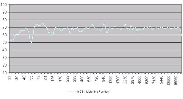

Notice the 89Hz null is gone at the listening position (3 meters) indicating it was likely do to measurement/room interaction rather than loudspeaker design deficiency.
This measurement was taken with the MCS1s set to full range with no subwoofer. The suckout at 50Hz is again likely a room node issue relative to speaker/listener placement. By crossing these speakers over and optimally placing the sub, much better bass integration and extension was achieved.

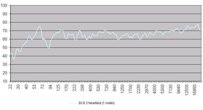

Measurements & Analysis of Thiel SCS3 Speakers
