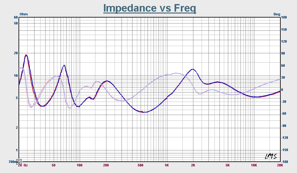

Impedance / Phase Measurements of the RBH Sound SX-6300/R Loudspeaker System

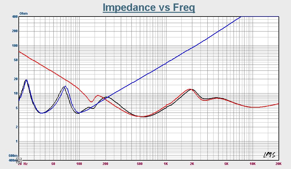

Above left are the impedance plots of the HF/MF section (red), the LF section (blue) and the entire system (black) of RBH Sound SX-6300/R review sample. Above right are the system impedance plots for
both speakers.
At the LF end of each system impedance plot we find a local minimum of just under 4Ω at 36 Hz, located between the two impedance peaks that are typical for a vented system. The frequency of this local minimum is a good indicator of the woofer/cabinet system tuning frequency.
At just under 530 Hz we find the review sample’s global impedance minimum of 3.2Ω. Based on this minimum the system can be loosely described as having a nominal impedance of 4Ω. 3.2 Ω is swinging pretty low, impedance-wise but at this 530 Hz minimum the impedance is almost purely resistive (1.2˚), so any competent solid state power amp should be able to handle the speakers impedance load. Having said that, If you enjoy listening at realistic playback levels, then heed RBH’s recommendation and power the SX-6300/Rs with an amp rated at 100W – 300W.
At right are the system impedance curves for both review samples. Presenting them in this way allows
for a quick comparison. Essentially, the closer the impedance plots match, the better. In this case, the curves closely resemble each other and indicate better quality control, system to system, and better matched performance between the speakers. The impedance moduli present no signs of any major mechanical or acoustical pathologies (e.g. panel resonances) being reflected back into the electrical domain.

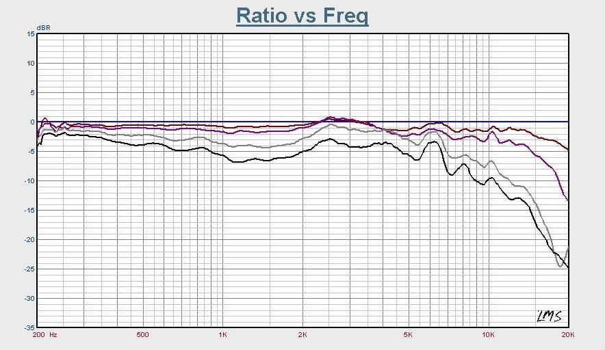

RBH Sound SX-6300/R system amplitude response, 1m, on-axis, ~2.828 Vac (left); system amplitude response at 0˚ (Blue), 15˚ (Dark red), 30˚ (Purple), 45˚ (Gray), and 60˚ (Black) off-axis (right) normalized to the on-axis response plot. All plots 1/12 oct. smoothed for visual clarity.

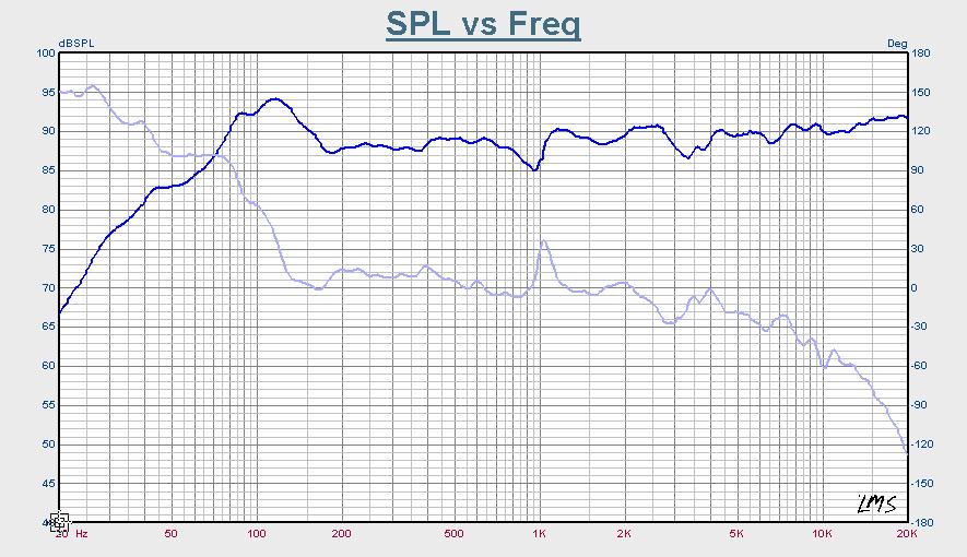

Above left is the amplitude response plot of the SX-6300/R. All measurements were done outdoors. Measured sensitivity was 88 dB (averaged 300Hz – 3kHz, 2.828V/1m). On the right are dB spl amplitude response plots for the system on-axis (0˚ (on-axis); 15˚, 30˚, 45˚ & 60˚ off-axis, 200Hz – 20kHz.
The dips in response at ~ 1 & 3kHz are visually more obvious than they were sonically. The dip at 3 kHz is particularly not concerning. Why? At around 3 kHz our hearing is somewhat less sensitive to diffuse sound. Recording mics, on the other hand, are usually flat, response-wise, even when operating within a diffuse sound field. On playback there is perceived more energy in the 3kHz range than would have been the case had you been at the actual recording location. Given that (and the fact that the human auditory system is less sensitive to dips than to peaks) and all in all the sonic impression they left were minimal. The peak seen at around 115 Hz manifested itself mainly when listening to male voices, such as a radio DJ, where it would add a bit of midbass warmth to the speaker’s voice. Otherwise it didn’t seem to detract from the systems performance, even when listening to recordings of unamplified instruments (chamber music, harpsichords, etc).

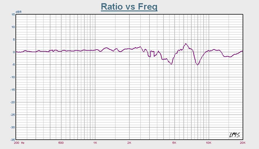

Left: dBr comparison of both SX-3600/Rs amplitude response loudspeakers when measured 1m, on-axis, ~2.828 Vac. At right: dBr comparison of the system response with and without the grill cover.
The SX-6300/Rs had a remarkable ability to keep images within its soundstage rock solid to a degree that’s not often encountered in less than stratospherically-priced loudspeaker systems. Comparing the amplitude response of both speakers (top, left graph) offers one explanation for this particular talent. Essentially the amplitude response of one speaker was normalized to that of the other. Any differences would then show up as a value other than zero dBr. As can be seen by the plot the two systems matched very, very well. Excellent!
