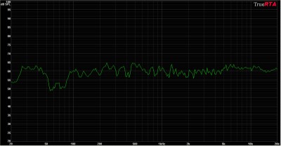

Measurements & Testing
For measurements, I used TrueRTA with a Behringer ECM8000 mic and an M-Audio Fast Track Pro external soundcard. For amplification I used a Sherbourn 2/75B amp. This setup gives me a lot of flexibility as to where and when I can do measurement. To start with I placed the speakers in my Ready Acoustics treated AV Rant podcast room. This room is small but extremely dead with 19, four inch thick panels lining the walls and ceiling and straddling all the corners. While the room isn't exactly an anechoic chamber, it is a heck of a lot deader than most people would ever experience and almost every wife on the planet allow in their home. To start with I measured the speakers 1 meter on axis.
Salk
Sound Veracity HT2-TL One Meter On Axis 1/24th Octave
(note - not
a 1 watt measurement)
As you can clearly see the Salks are extremely linear all the way through the bandwidth. The suckout between 50Hz and 90Hz is surely room/mic interaction. I verified by measuring the drivers nearfield and no suckout was present.
Salk
Veracity HT2-TL 1/2 Meter, 1/24th Octave
Purple
- On Axis, Yellow - 15 Degrees off, Orange - 30 Degrees Off
Up closer to the speaker you start to see a dip at 2k (something that is just barely noticeable in the first graph). This is where the tweeter and the woofers cross over which is more prominent up close because the microphone is too close to accurately measure the summed output. The interesting thing is the linearity of the speaker. On the top end, the On Axis and 15 degrees off are almost identical. The 30 degrees off is showing a bit of a dip but it still looks very good.
Salk Veracity HT2-TL Impedance/Phase vs Frequency
The Salk Veracity HT2-TL actually measures more like a 5 ohm speaker but Salk appears to be rating it conservatively. There is a pretty sharp impedance peak at around 1200Hz causing a phase shift of about 75 degrees but it shouldn't cause any amplifier problems. Salk is using a higher order network to reduce the on axis response of the woofer before the crossover frequency which helps preserve its linearity. This is a common practice among competently designed loudspeakers such as the HT2-TLs.
