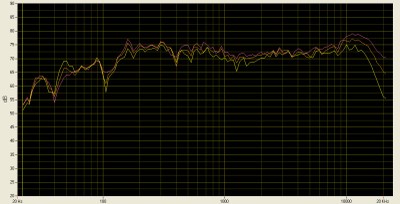

Using the Sencore SP395A FFT Audio Analyzer, I measured the SongTower's in room on and off axis frequency response with 1/12th octave resolution.
SongTower 1 Meter Frequency Response (1/12th Octave) On Axis
SongTower 1/2 Meter Frequency Response (1/12th Octave)
Pink - On axis, Orange - 15 degrees off axis, Yellow - 30 degrees off axis
Disregarding the graph below 200Hz (due to in-room measurement inaccuracies) the response looks quite linear with a very smooth off axis response. The slightly recessed mid frequencies implies the tonal response of this speaker is a bit laid back or relaxed.
