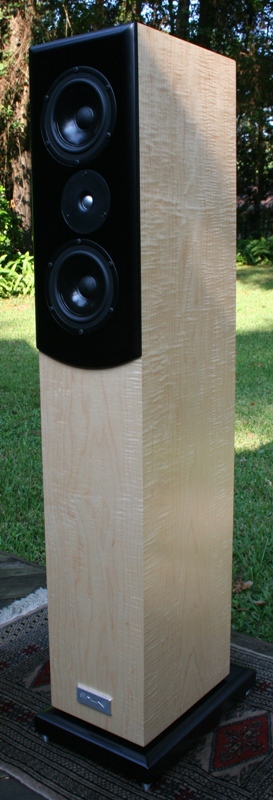

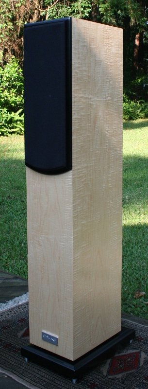

Salk_Back.JPGUnwrapping the speakers, the care and quality of the finish is evident. I opted for the Natural Curly Maple which has a very light yellow hue with a very interesting rippled grain. The plinths and that front plate around the drivers are raised and a glossy black. At the bottom of the front of the speaker is a milled aluminum plate with the Salk logo. I really like the way this looks and much prefer it over the typical plastic logo on the grill. The rear has the two five-way binding posts unceremoniously sticking out of the back (most speakers have them mounted in a plastic housing). At first I wasn't a fan of this as I was afraid that the speaker lying on its back (which I was going to have to do to remove the drivers) would damage them but the design of the plinth elevated the speaker enough as it was lying on its back so that posts were protected. I was surprised to find that the speakers were not bi-ampable. I've seen speakers at a much lower price point that are. Personally, I don't have an issue with this since I think it takes a very specific speaker design to require separate amps but most consumers would expect two pairs of binding posts. Since Salk builds their speakers to order, you could request bi-ampability though it would come at an additional cost. There is a large flared port at the bottom of the back of the tower. The front of the speaker sports the two Seas CA15RLY 5" woofers and the Hiquphon OW4 tweeter (a drop-in upgrade from the standard OW2 that adds $100 to the price of the speaker) in an MTM configuration.

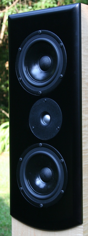

Salk_Front.JPGThe speakers are very tall (as you would expect with an MTM design in order to get the tweeter to ear height) at ~47" high. The tweeter is ~37" off the ground which is just about perfectly ear level for my seated position. The speaker itself is deep, but not very wide which makes placement a little easer than the other way around. The plinth on the sides and front only flare out an inch but the speaker feels very steady and solid. At 55lbs, your child or dog is going to have to really work hard at knocking these things over.
The finish on the SongTowers is impeccable with absolutely no flaws that I could find. The raised black area around the drivers and the plinths are a gloss black (called "black satin lacquer" by Salk) but not the high gloss "piano" finish that you see on some other speakers. The black finish is very nice and smooth and while reflective, doesn't seem to attract the amount of dust and smudges that the high gloss does. The "spikes" provided by Salk weren't really spiky - they have a sort of sparkly metal finish and are rounded at the tip. The threaded post actually detaches from the "spike" fairly easily. A little thread-locker would probably correct this. There are no provided rubber feet though the rounded tips should be fairly safe on hardwood floors.

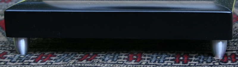

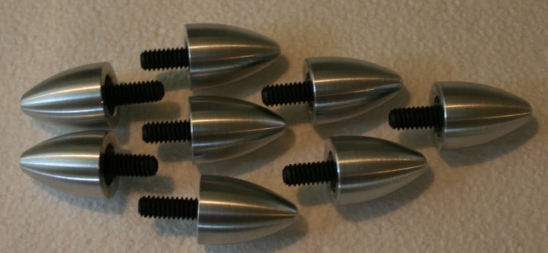

Salk_spike.JPGThe problem is that the spikes won't pierce a carpet which is sort of the whole point of the spikes. These seem to be mostly just for looks from what I can tell. Salk does have more traditional carpet spikes that are adjustable and much sharper available upon request (for an additional cost). The bottom of the speaker has a short raised piece which gives the speaker the appearance of floating off the plinth. This also means that if you added on some aftermarket outriggers, you'd end up with the appearance of floating off them as well. If the raised portion was part of the plinth and not the speaker, outriggers would be much more of an option.
Salk_Base.JPGAttaching the plinth is fairly easy though the screws are HUGE. A socket set is definitely recommended. Remember that the short side of the plinth goes towards the front of the speaker. The overhang of the back protects the binding posts if the speaker is laid on its back. The edges of the speaker are fairly sharp but not as bad as I've seen with some other Internet direct speakers. The black front plate is nicely rounded as is the top of the plinth. Personally, I am much more impressed with the looks of this speaker in person than I was when I saw it online. I thought the black faceplate looked a little weird from the online pictures but in person it looks very nice.

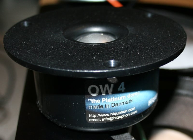

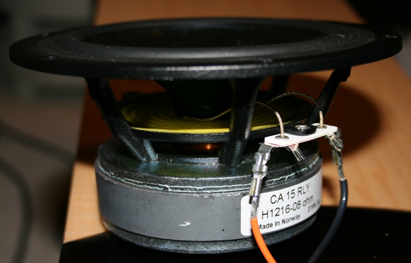

Taking the speakers apart is only possible from the front by removing the drivers. I confirmed that the woofer was in fact the Seas CA15RLY though the tweeter was the Hiquphon OW4 instead of OW2. As we mentioned, Salk says that the OW4 is a drop-in upgrade/replacement for the OW2. The cabinet is constructed out of 3/4" MDF with three large braces up the length. The braces are all slightly inset into the cabinet and glued into place. At 55 lbs a piece, the SongTowers are well braced and very inert.

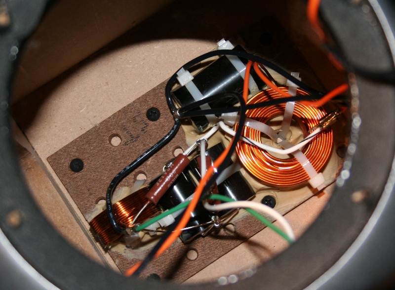

Salk_Crossover.JPGAll the internal wiring was done with 14 AWG silver coated oxygen-free copper wire. The Hiquphon OW4 tweeter is enclosed in its own plastic backbox obviously provided by the manufacturer. The wiring for the tweeter is soldered on directly. The crossover uses very high quality air core inductors properly oriented to avoid crosstalk coupling, and audiophile polypropylene capacitors. At first I thought Salk was using hot melt for holding the parts down. It turns out that this was not hot melt but heavy-duty construction adhesive. A few years ago they started having problems with shipping damage. The cabinets arrived just fine, but heavy air coils were being ripped off of crossover boards (especially by UPS). They experimented with many different solutions until they came up with this adhesive. Once the adhesive off-gases (in about 24 hours) it bonds so well you have to use a chisel to remove components from the crossover board. This, coupled with the liberal use of tie-wraps has virtually eliminated crossover shipping damage. In fact, they have had zero failures in the two years or so they have used their present system!
