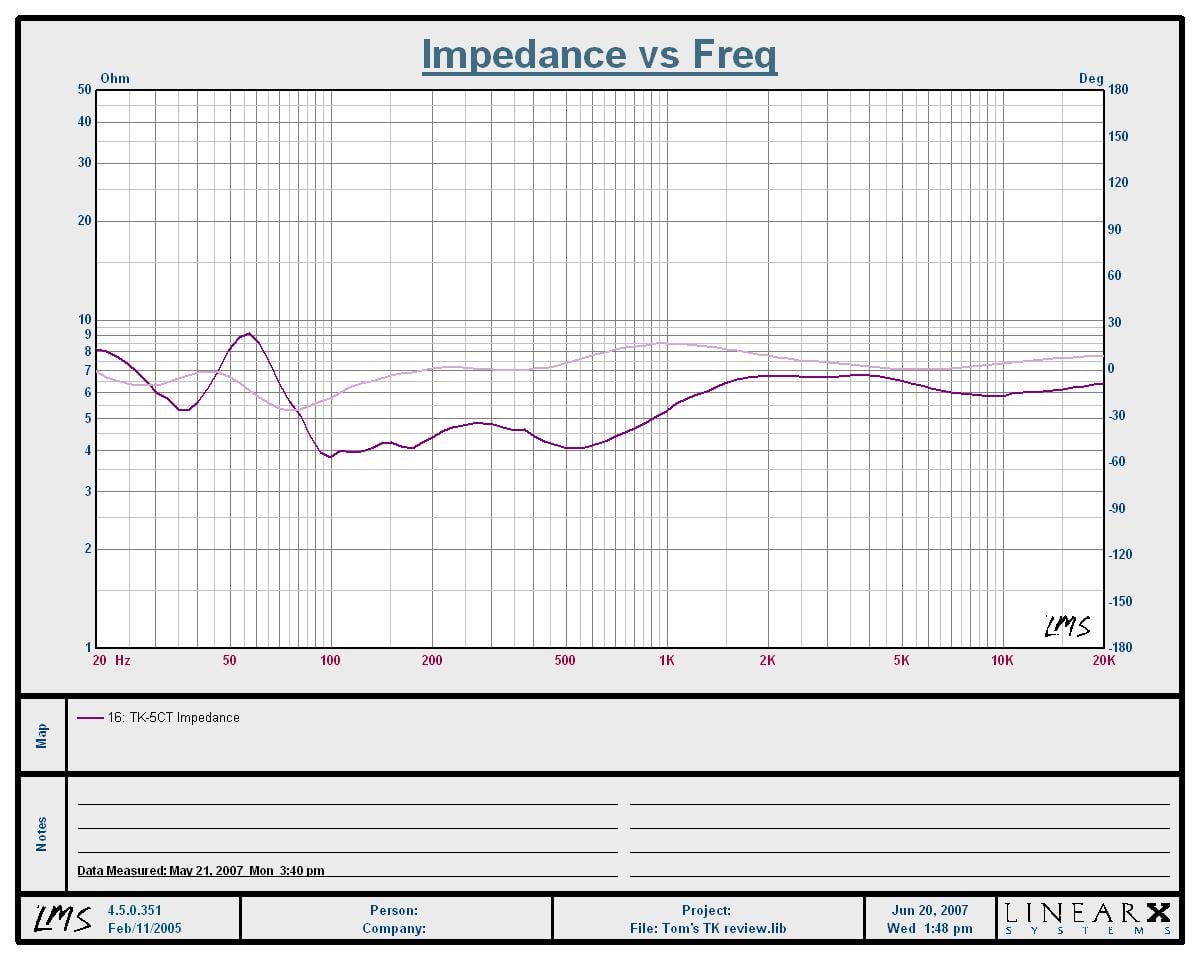

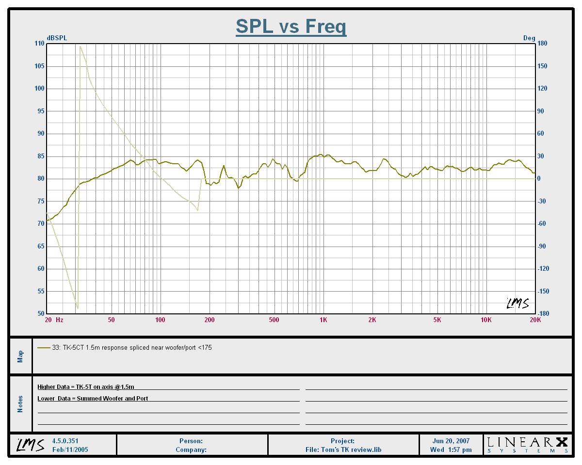

TK-5CT Impedance / Phase
 As can be seen in the plot, the RBH TK-5CT tower is roughly a 6 ohm speaker.  Given its moderate sensitivity and dip to 4 ohms in the mid bass region, it is advisable to use an amplifier that can safely handle low impedances and put out an honest 100wpc or more.  The phase response is extremely linear, maintaining  +-30deg within the entire audio band demonstrating the designer really knows what he is doing to make a speaker that can consistently perform well regardless of what type of amplifier is powering it.  Based on the saddle point centered around 38Hz, the manufacturer does seem to be conservatively rating the systems bottom end response.

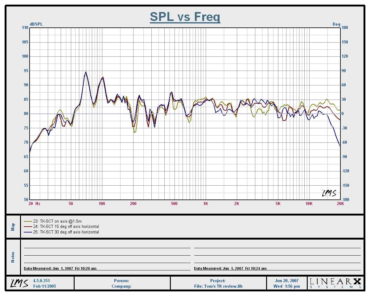

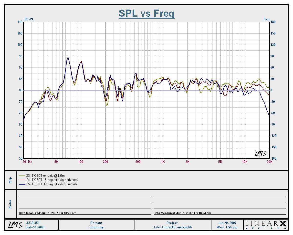

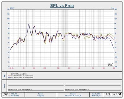

TK-5CT In Room Frequency Response (1/12th Octave Resolution)
Yellow – on axis
Red – 15deg off axis
Blue – 30deg off axis
The TK-5CT towers exhibited a very linear frequency response on and off axis.  Notice the on axis plot doesn’t reveal a tweeter level deliberately set to high as we often see in budget towers to win over that “wow” effect.  There also is not smiley face response where the midrange is recessed to hide speaker deficiencies.  This helps explain why Tom enjoyed both on and off axis listening with this speaker system.

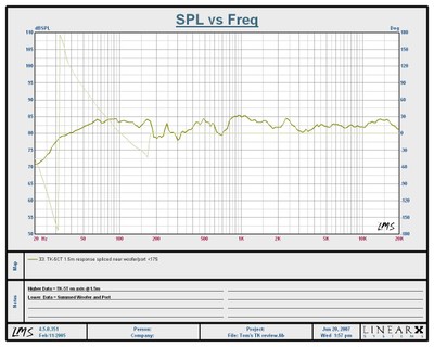

TK-5CT Spliced nearfield (woofer + port) response
To get a better idea of speaker performance and take the room out of the equation, we measured the nearfield woofer + port response and implemented 1/3 octave smoothing above 200Hz.  As you can see, this speaker is tonally neutral, without overemphasis in any frequency spectrum.  The 3dB point does appear to be around 45Hz but with a very gradual and smooth roll off of around 10 dB/octave below that.
